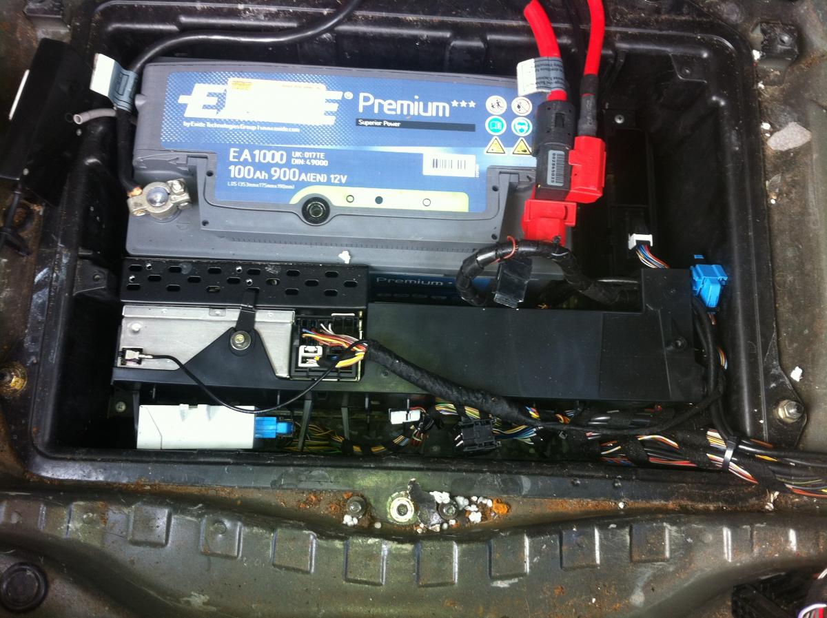

Have you checked the module near the battery? These have a habit of getting damp and corroding the board(s)... A good idea is to find a friend with one and swap over just to test !!

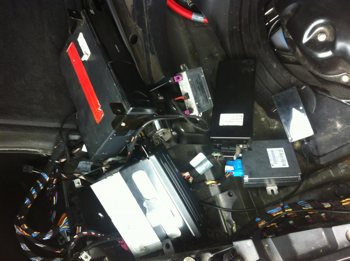

I spoke to a technician at BMW's quarry motors in Sheffield. He said the likely cause is to disregard and by pass the traffic assist module. Any idea where this is? He said it
is in the left side wall in the loading area or is it the one you have sent me in the image? Where do I by pass it to? Cheers
The left-side would hold the TM, Aerial amp and maybe Multi-CD changer...
The TM would have IN/OUT so loop these making it redundant. If I am right you can get a small bypass lead for it.
Hi again. I've got the head unit out, traffic master switch, cd multi changer, sat nav, two silver box's, amp and what I think is possibly the hands free kit. Still can't figure this TA bypass.

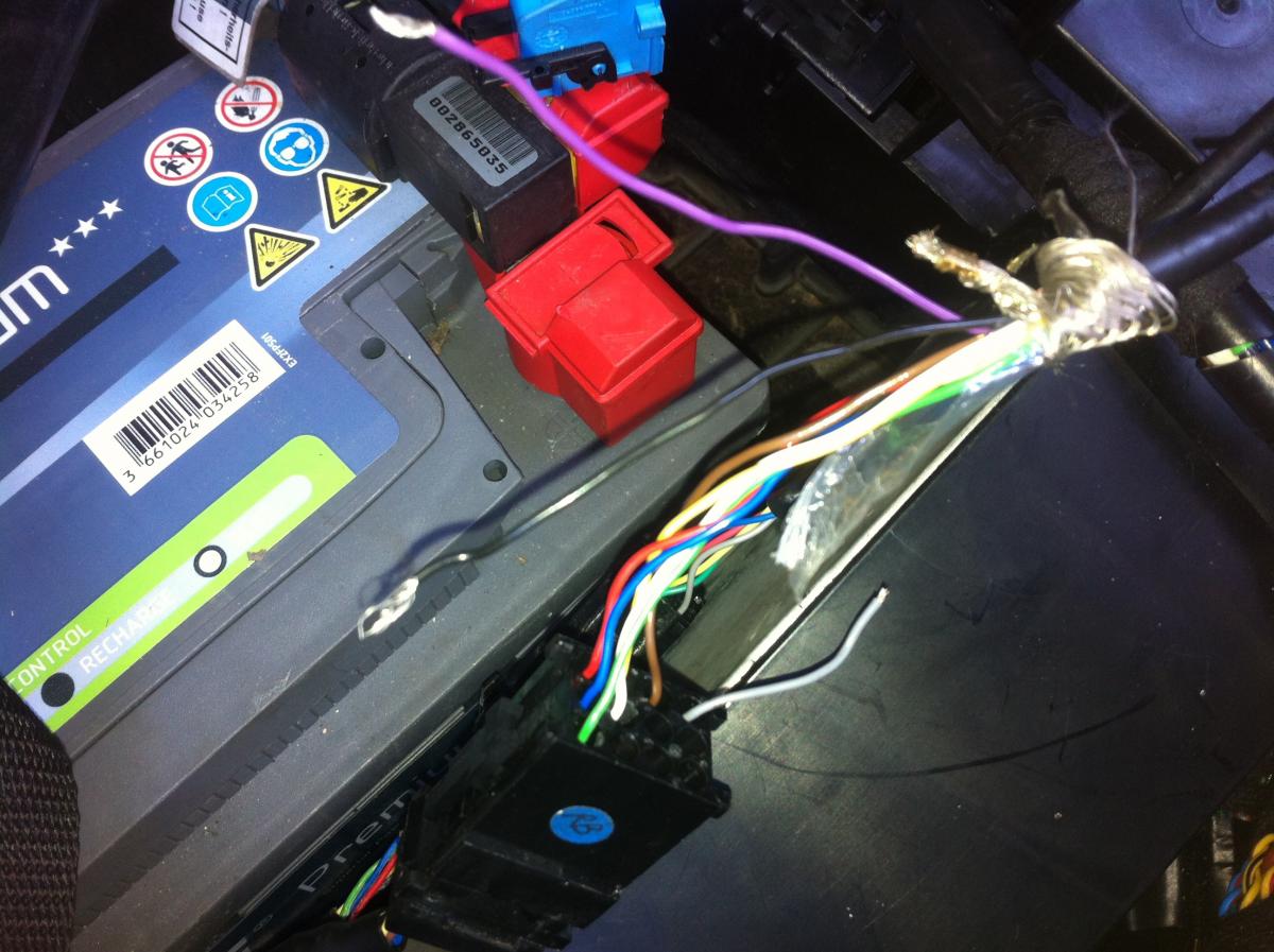

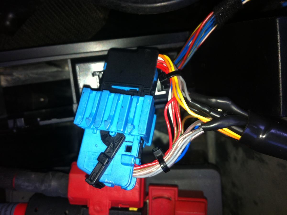

I think I've found the TM. Black unit with a blue plug and blue socket (joined together?) two black sockets and a loom. There was a black and purple wire broken and a grey wire which doesn't go anywhere? I've pushed the broken wires back into the plug and still nothing. What do I do to bypass it now? Cheers
