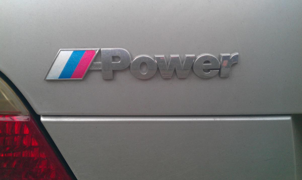

Quick one for you! What does this badge mean on the back of my 2000 728i?
I think it's just something stuck on for the fun of it but people keep asking so thought I'd ask!

wow really? No wonder it takes off everytime I go over a mini roundabout!
Am I Knight Rider then?
Do you wear a leather?
So I should take it off, in other words. I think it looks cheap / unoriginal
Basically...yeah..
Some hoper before you got it from Halfords
hoping it won't take the paint off when I remove it.....
Use an old bank card to pry it off. I use "StickyStuffRemover" along-side the old bank card to dissolve the adhesive.

yeah, I will do. Just so paranoid about leaving a mark! It looks quite old. Wonder why anyone would feel the need to stick this on such a great car that speaks for itself!
Don't worry about the mark fella.
Old debit card or tesco club card at hand. carefully run the card under the badge and push the adhesive out. If the adhesive is solid, use a solvent to soften it like StickyStuffRemover (Halfords, 5quid). When removed, if there is a colour difference, T-Cut will solve that.
This method DOES work as I removed the 520i badge from my 1987 5 series using this method. That shizzle was stuck on for 25 years
