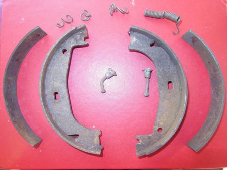

Now something a little more drastic, during one of my short trips there was a loud bang, bang, bang from the rear drivers wheel... stopped checked could not see anything, set off and bang again, slowly slowly me thinks lets get off this A road (kids in the car) then the noise goes completely, did the 50mile trip no issues, then yesterday hear this metallic screeching noise like when the dust cover rubs on the disc and a couple more bangs which could be felt through the car, I have had the car up and checked for play in the bearing cant feel any, moved the dust guard away from the disc and bits of crap and rust fall out... if the bearing had failed I would feel the lumps and knocks when driving but nothing, the hand break on that side is useless and got me thinking could the shoes of failed and disintegrated hence this grinding noise.
I tried to take the calliper and disc off but come stuck at the top 7mm bolt which is blocked by the shock is there a way round this, should I undo the bottom bolt on the shock.. bearings and shoes are cheap enough so will do the job myself if I can get hold of a hub nut socket of some sort..
Morning all, well I have resolved the issue with the rear drivers wheel, the cause was in fact failed hand brake shoes, snapped springs rivets ripped out of the backing dust plate, the brake pads had actually detached from the shoes and everything was a bit like a Scrambled Brakefast...
