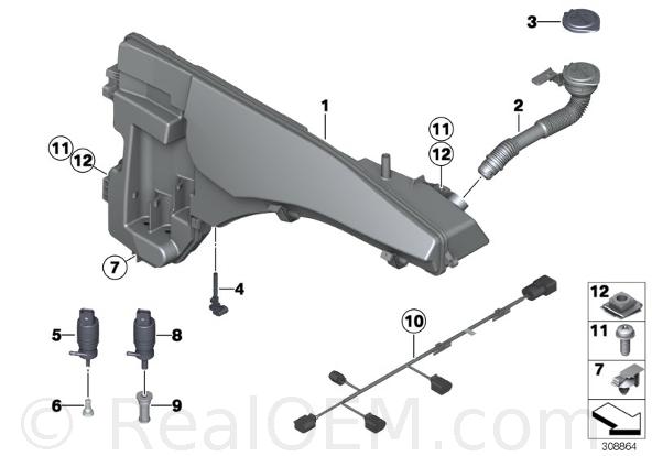

Just looked on realoem your car has 2 pumps item 5 & 8 filters 6 & 9
It looks very similar to mine you need to almost empty the washer tank to save losing to much fluid (that or park over a drain) take out the pump and wash the strainer/filter and put it back straight forward enough job
Afraid so I did mine when I was down to almost empty on the washer tank. Both my filters were clogged with a white scummy gunge, not difficult to clean just a pain having to almost drain the tank. It was a year ago I did mine.
You can see the filters on the drawing they push fit to the bottom of the pump
