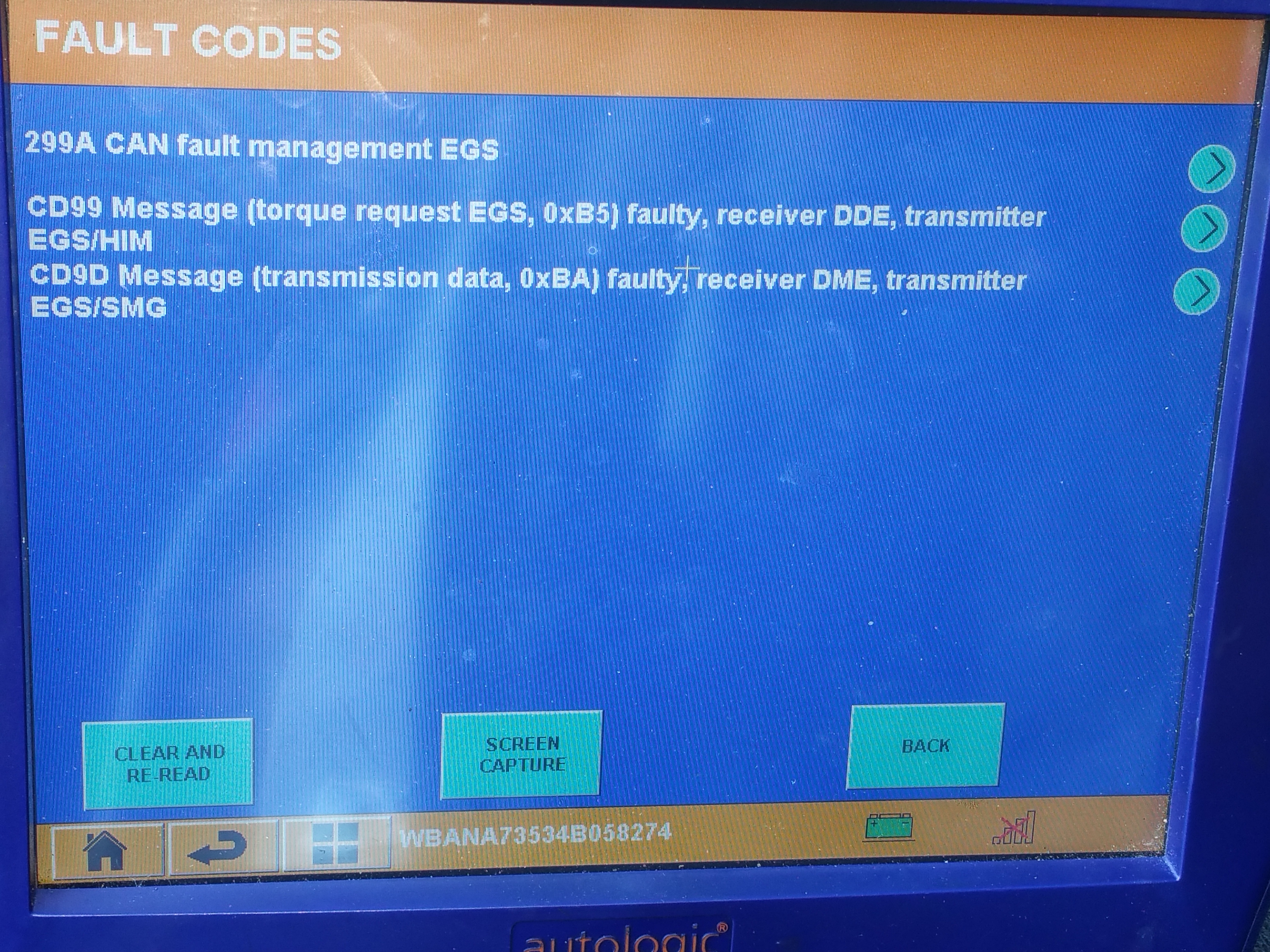

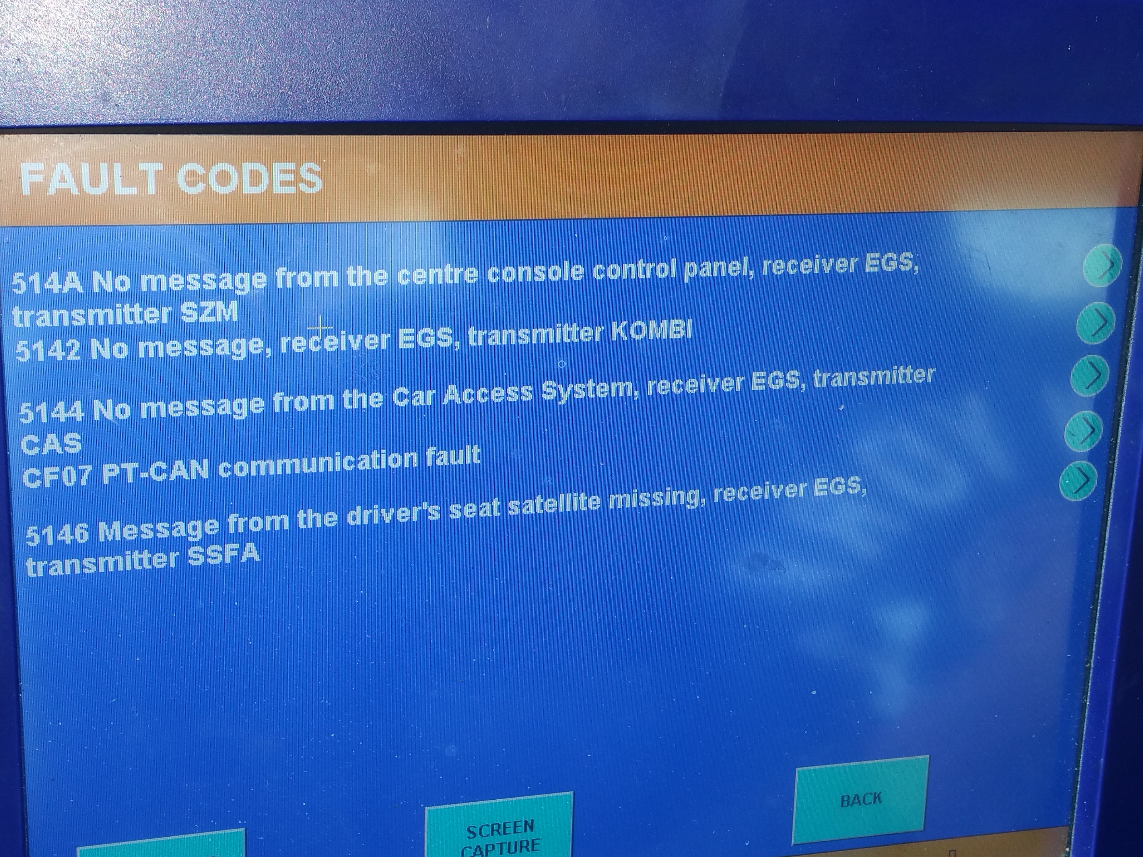

Here are the Codes AutoLogic pulled up, along with the screen shots below.
514A-No Message from the centre console control panel, receiver EGS, transmitter SZM
5142-No Message, receiver EGS, transmitter KOMBI
5144-No Message from the Car Access System, receiver EGS, transmitter CAS
CF07-PT-CAN Communication fault
5146-Message from the driver's seat satellite missing, receiver EGS, transmitter SSFA
299A-CAN fault management EGS
CD99-Message(torgue request EGS, 0xB5)faulty, receiver DDE, transmitter EGS/HIM
CD9D Message(transmission data, 0xBA) faulty, receiver DME, transmitter EGS/SMG

Where do I start? Obviously there is a communication problem with the EGS or the Dash Cluster. Is it the EGS or the wiring that goes into it? I have no idea!! Tried searching the codes, not much out there. Hoping you guys can point me in the right direction. Mechanic can fix it, once I point him towards the problem. Last resort is take it in to BMW and have them diagnose it.
