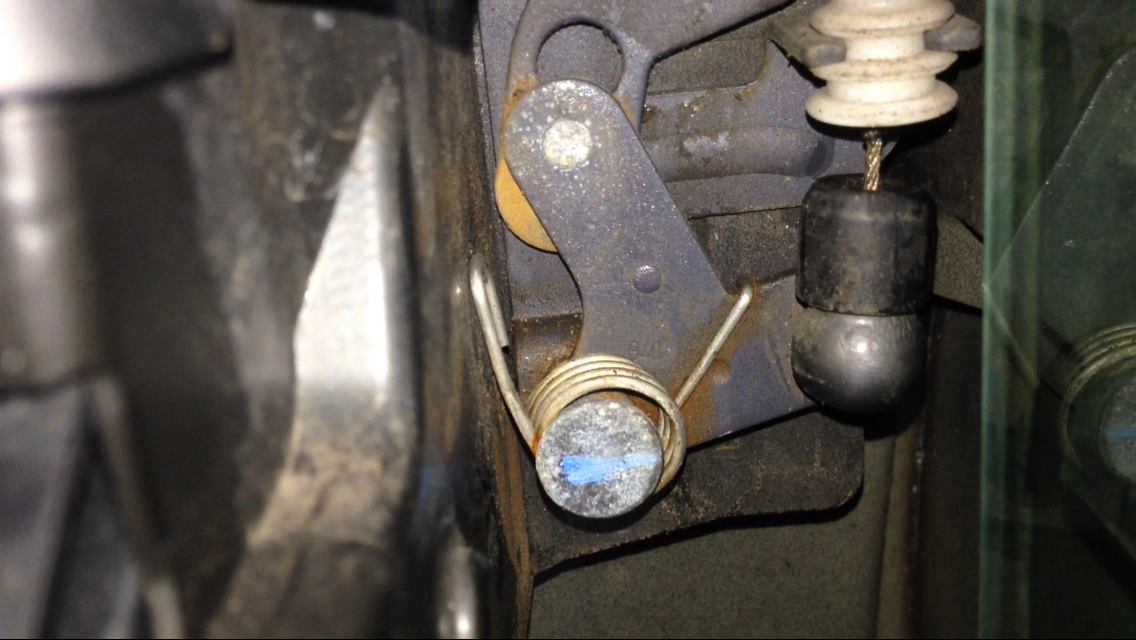

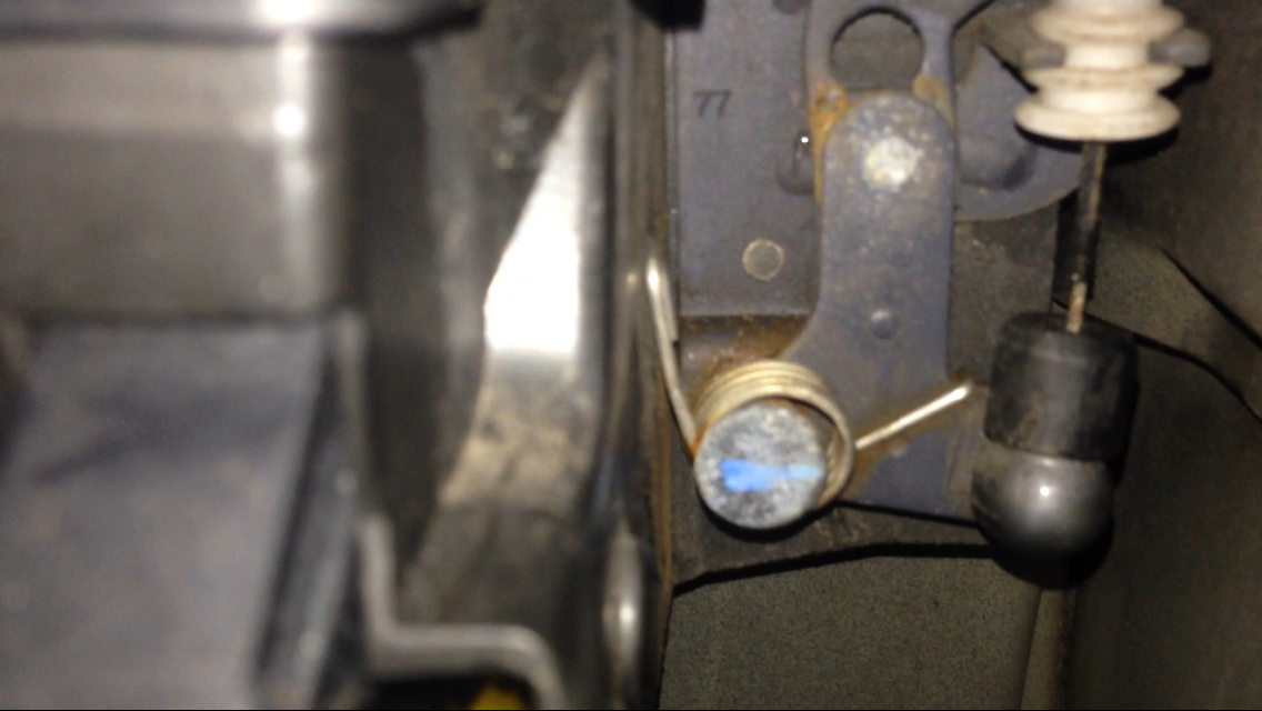

Right guys i'm at the point where i've meant to hook the mechanism and open the door, but it hasn't went like that. I'm stuck. Don't know whether i'm hooking the wrong bit or it just isn't working. i've hopefully attached a couple of pics. Is it any of the parts in the photos i have to hook? i'm trying to hook where the little ball socket is, well the bracket that its attached to. but i'm getting nothing. And when i operate the outside handle, it seems to be at its maximum travel (photo on the left hopefully) in the fully open position, so how can i open it when its at its most open position with th door handle? where am i going wrong? i haven't put the door panel back together just left it in a rage lol
Panic over, found the will to go back out and sprayed the latch with wd40, left it a few seconds to think what i was going to do next and tried the handle, opened not a problem. So got the door card off and worked and sprayed the latch until i was happy then generously applied that lithium grease greydog was on about. Its all on now and everything works (thank god). I'm half tempted to take the door cards off all the doors and lubricate the latches to prevent this happening again, because that was a pain in the !Removed!.
