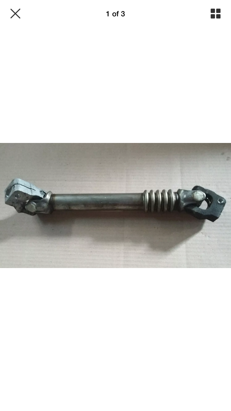

Hi Trevor
after closer inspection and getting someone to turn my steering wheel slightly from side to side (within the area of play) while I had my head under the bonnet and looking at the steering column I could see that there is wear in the lower universal joint on the steering column that attaches to the top of the steering rack, the play is in the actual knuckle of the universal joint itself. Finding it slightly tricky to find a spare though that's brand new... I have a second hand one in excellent condition so I might have a go at fitting that one for now until I can source a brand new one. Has anyone ever changed one of these? Seems reasonable... 2 pinch bolts... any advise would be great!
cheers
alistair
Just make sure you don't turn the steering wheel at all whilst it is all disconnected as there is an SRS rotary coupling which can be damaged if turned beyond its limits, otherwise, its just nuts and bolts.
