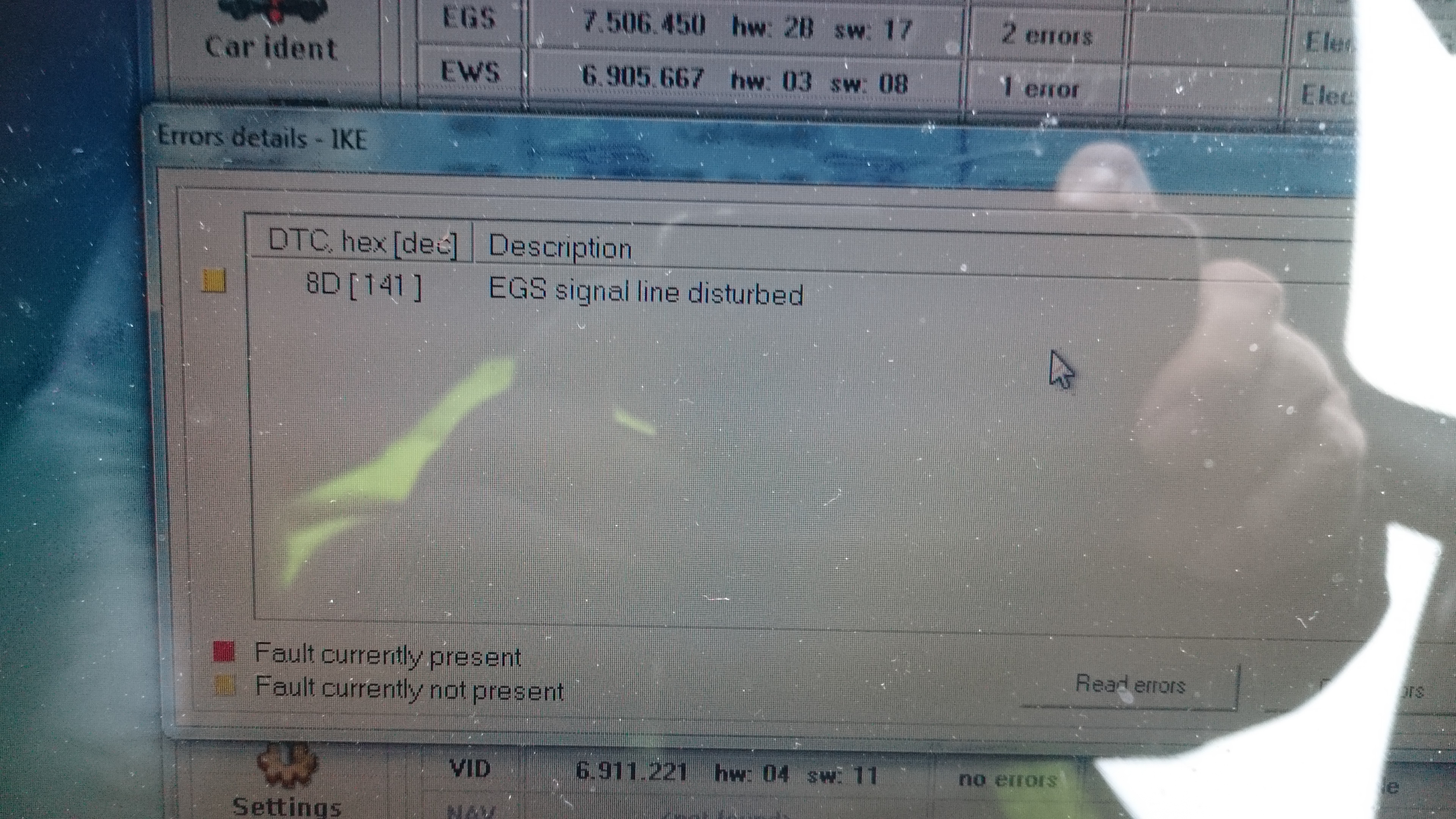

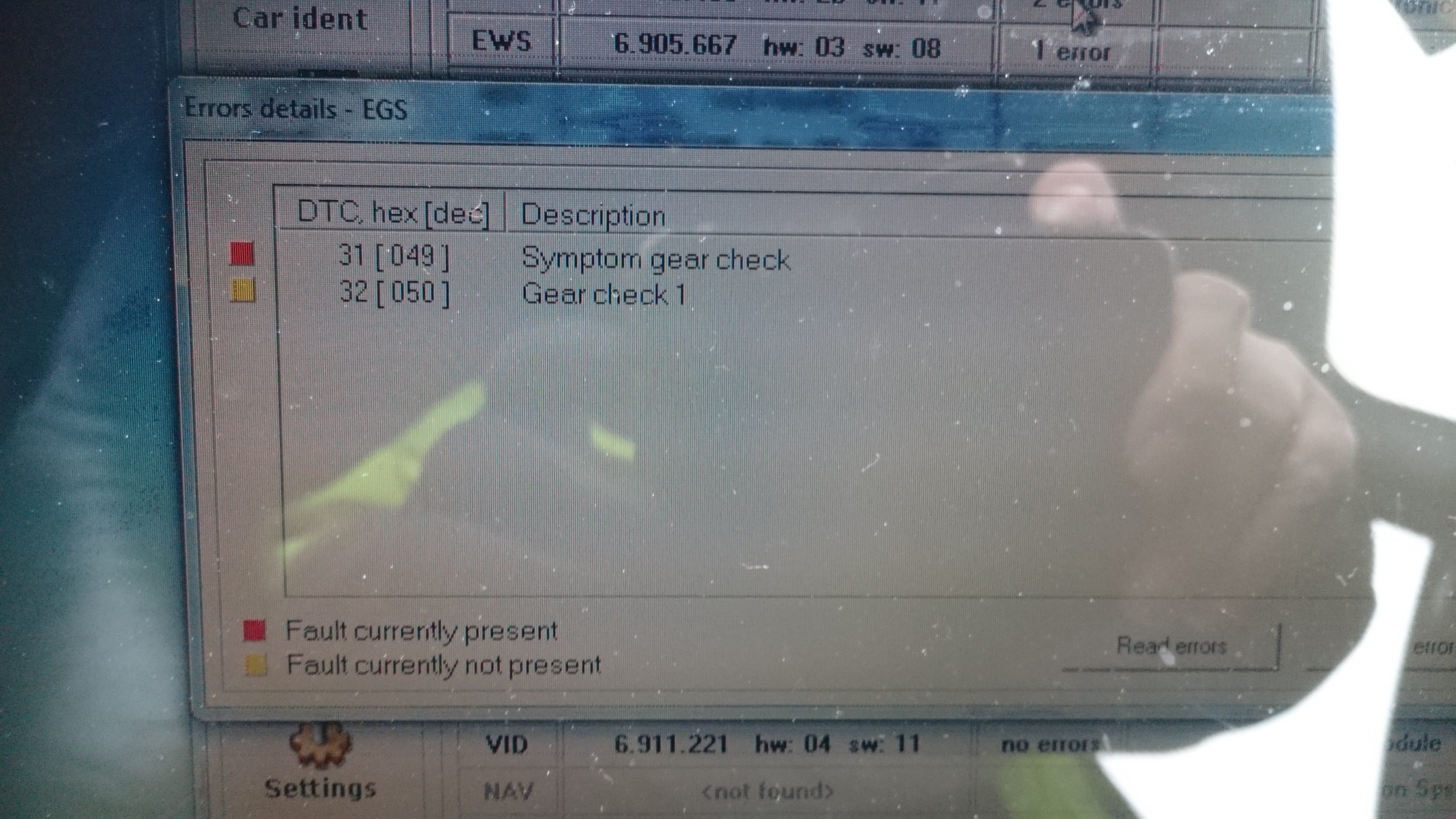

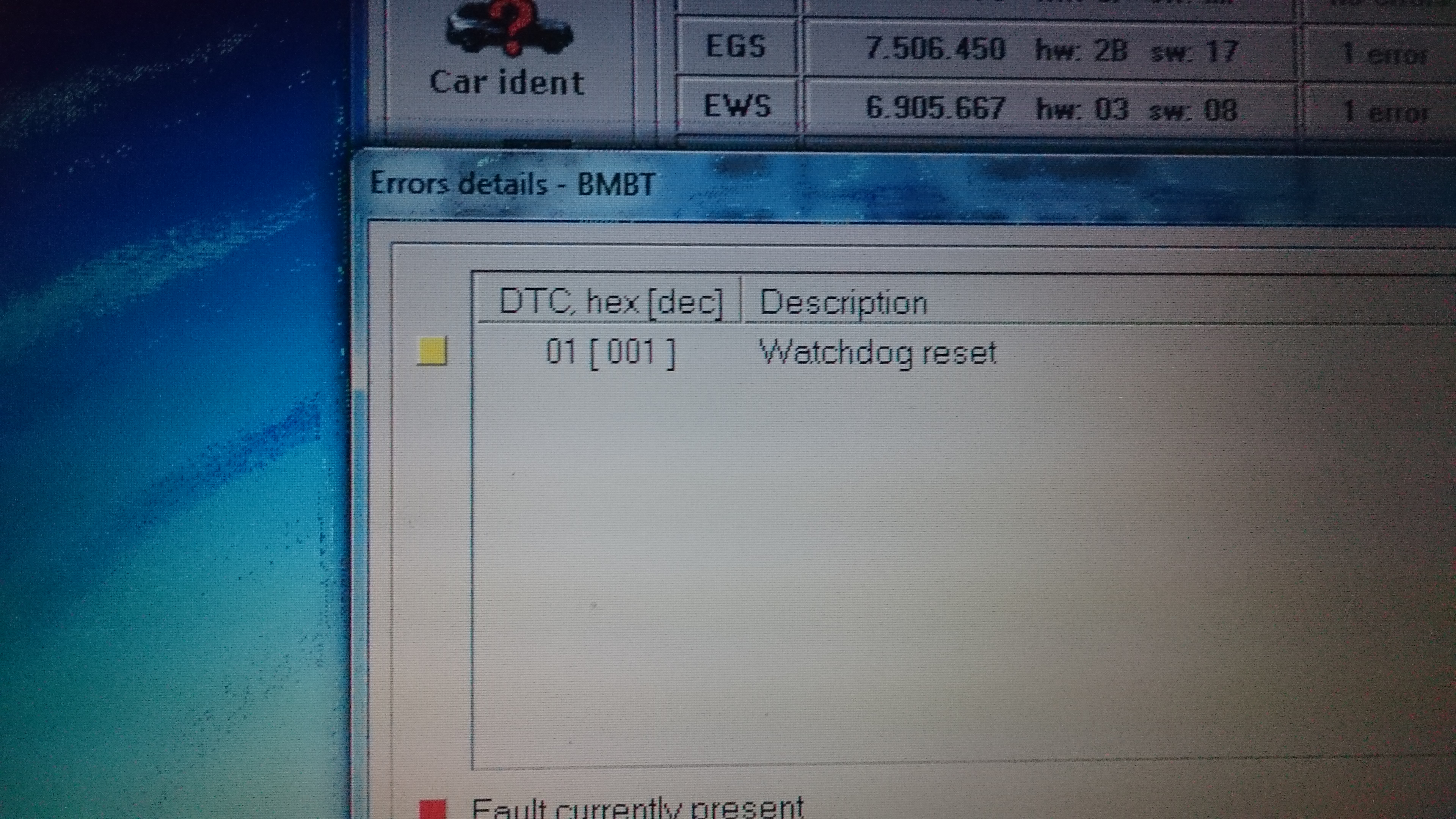

Got four error codes
31 049 symptom gear check
32 050 gear check 1
8D 141 egs signal line disturbed
01 001 watchdog reset
Codes 31 and 32 seem to come back after reset and drive..
