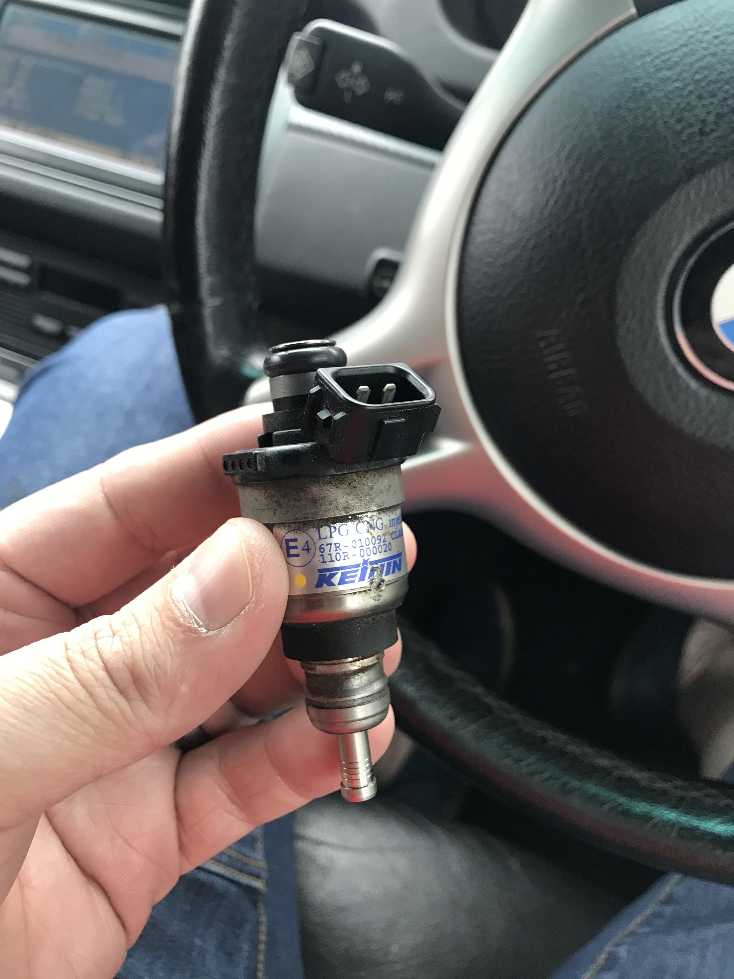

Thanks all for the replies the problem is fixed fingers crossed it stays that way the problem was one of the lpg injectors has failed which was causing the engine management system to cut out that coil on that cylinder which meant when I was running on petrol it was the same
