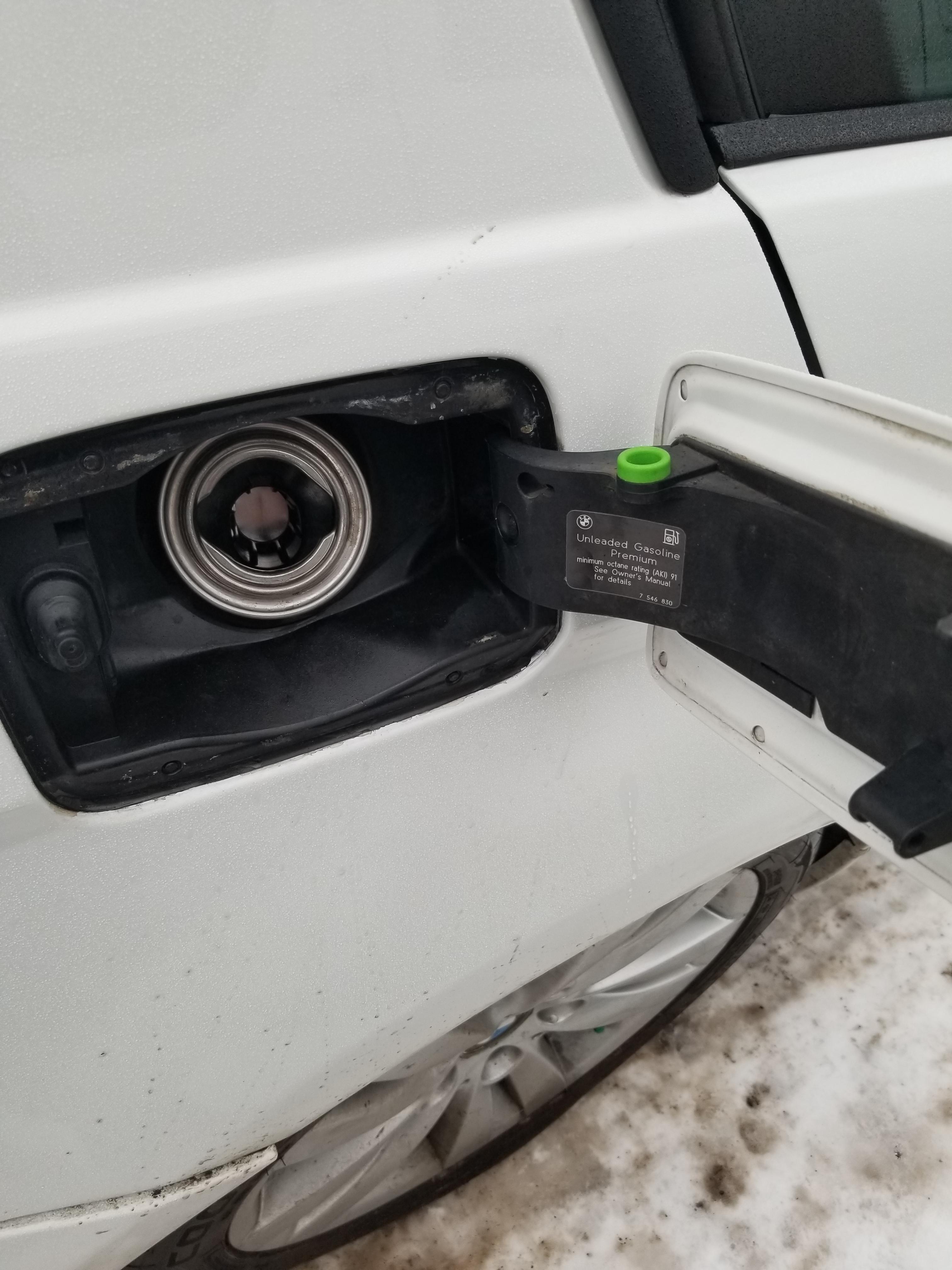

Well, I feel like a complete idiot.
The car finally told me what the problem was.  It flashed  "Tighten fuel cap" on the display and I was thinking this thing doesn't even have a gas cap....
I just assumed it didn't have one since newer Fords don't have them.  Checked the manual, found that yes, it's supposed to have a gas cap, and $30 later, I have an aftermarket gas cap.
I always wondered what that green thing was for.
So now we know why it was so intermittent.  It only happened if I was going slow when the emission system requested a purge of the gas tank.
Oh the simple things in life !! been there myself with stuff like this before. I do know the cap has a relief valve in it so if you can get a genuine one from that well known auction site it would probably be better or is your replacement a correct fit?
How brilliant that you haven't bust your wallet changing parts, I see you still have the white stuff on the ground!!
Well...that didn't fix it.  It made it much better, it took two hours to start doing it instead of 30 minutes, and now it will keep running if it's in DS mode, it only stalls in D.
