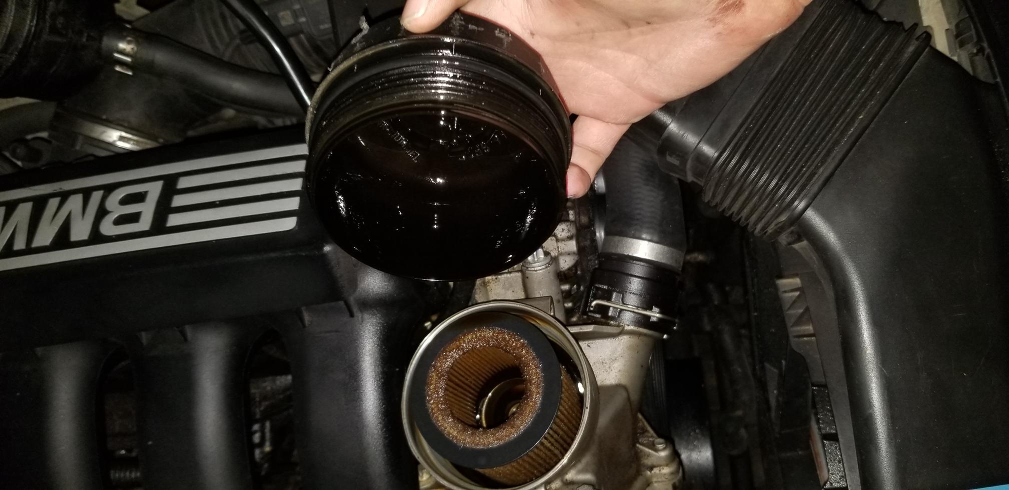

Well...I dug all over Google looking for other causes of the 2A87 code I'm getting.  There are the scary ones (Bad camshaft lobe, broken camshaft gear bolts, bad VANOS solenoid) and then I saw someone say they replaced their oil filter cap insert and it solved a 2A87 issue.  So, I checked mine.  I don't HAVE an oil filter cap insert, although it's obviously supposed to have one.
The part labeled as "2" in the drawing is completely missing.  Some idiot must have changed the oil and tossed it with the filter.
Now I just have to find one of the things... every store in the city is out of stock.  I may have to order it.

The new oil filter housing cap just arrived, so I've had a chance to look at that missing center bit.
Is that missing center piece the an oil pressure regulator and anti-drainback valve?
no wonder it ran like crap once it warmed up...  amazed it ran at all.
Once all these silly issues are out of the way you will find a BMW under there somewhere. By the stuff you have found a previous owner employed a primate with thick fingers to service it.
As I understand it is a pressure bypass if the filter is clogged it allows a flow of oil, but if you haven't had one in there I guess oil has circulated but not been filtered properly. That could explain crud getting to the Vanos solenoids, engine flush and oil change time?
That's what I've read elsewhere too, but just looking at the design of the part (A piston on a spring) and location and symptoms of the part missing being the same as low oil pressure, I think it's actually a pressure regulator, which just has the side effect of causing oil to not get filtered when it's missing.

Just got the car back from the recall repairs, and I took the opportunity to ask what that part under the oil cap actually does.
It's the oil pressure regulator.
