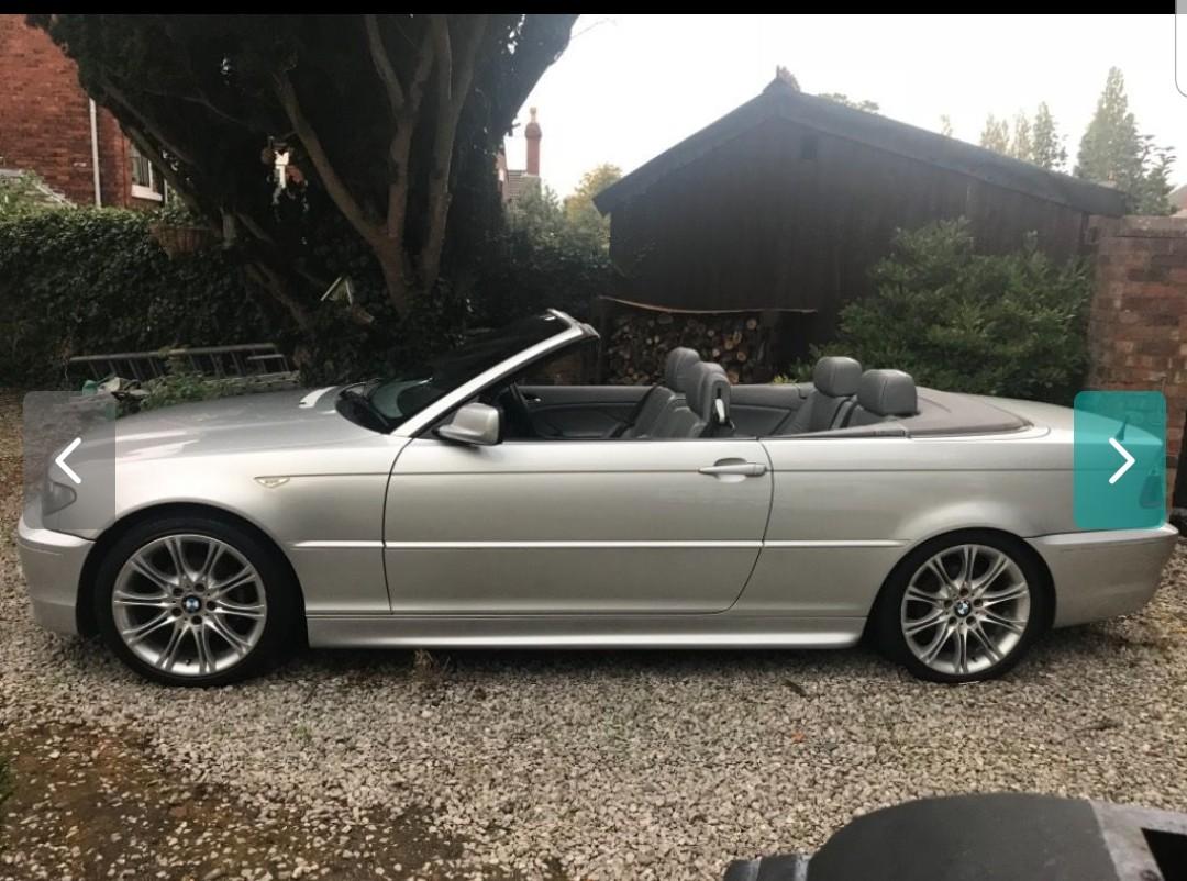

Hi guys, I've just purchased a 2005 318ci, it's my first BMW but I'm unfortunately already having issues with it, while smoke from the exhaust and the convertible roof has stopped working.
