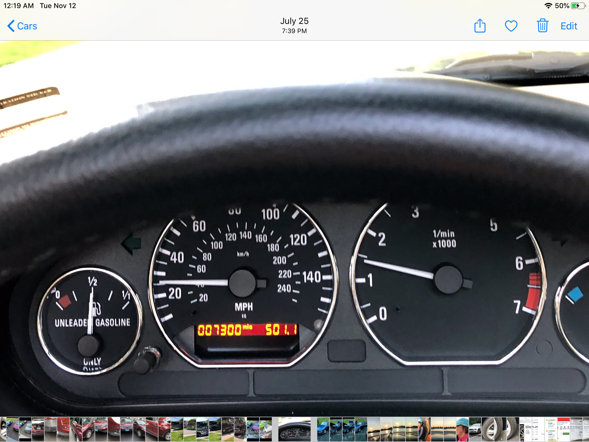

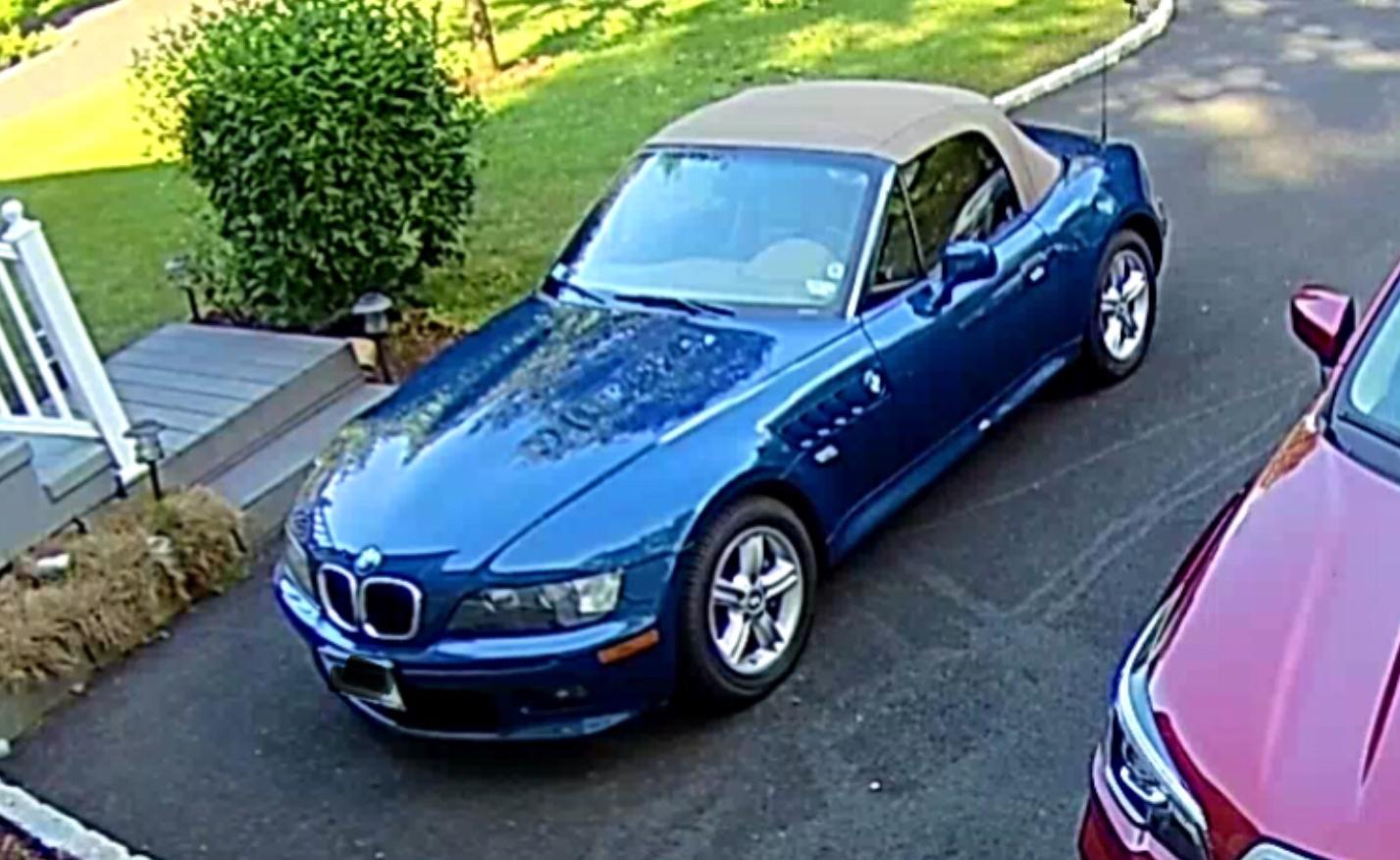

I just acquired a 2001 z3 with 7,500 miles (12,000km) on it. The car was garaged and owned by my parents. It is 100 percent original, including the tires, which I just replaced as they are 18 years old.
I need advice on what maintenance items I should do to the car. It literally looks like it just rolled off the showroom floor. But it is 18 years old.

Wow what a find, lucky man

It's a nice looking car. All you need now is sunshine.
