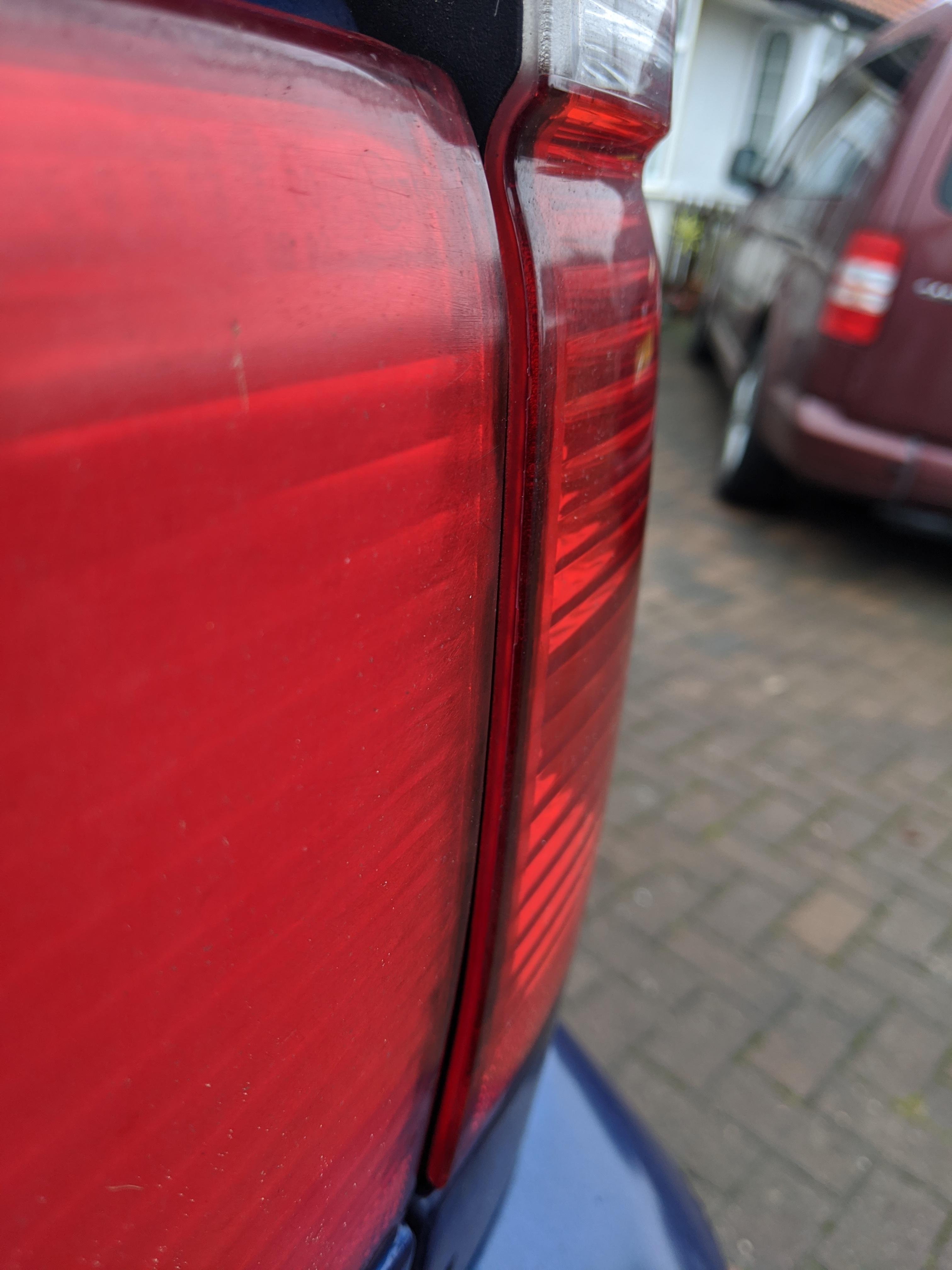

I have a funny feeling my friend might have forced the Hatch shut yesterday when trying to get the pool table into the back but I will try the WD40 option. The reason I say it might have been forced closed is when I have just been looking at it the the end of the Hatch that is stuck seems to be further in in as you can see by the photo where has the other end the lights are flush

From memory the locks are cable operated from the central solenoid. So it is possible that the cable has become dislodged or broken. I would look at www.realoem.com to see how it goes together it should be possible to get some grips on the cable inner after removing the trim panels on the inside.

You are right. We did it 2 days ago. I forgot to update this thread. We took the panal off the back and a cable had been dislodged. All working now cheers
