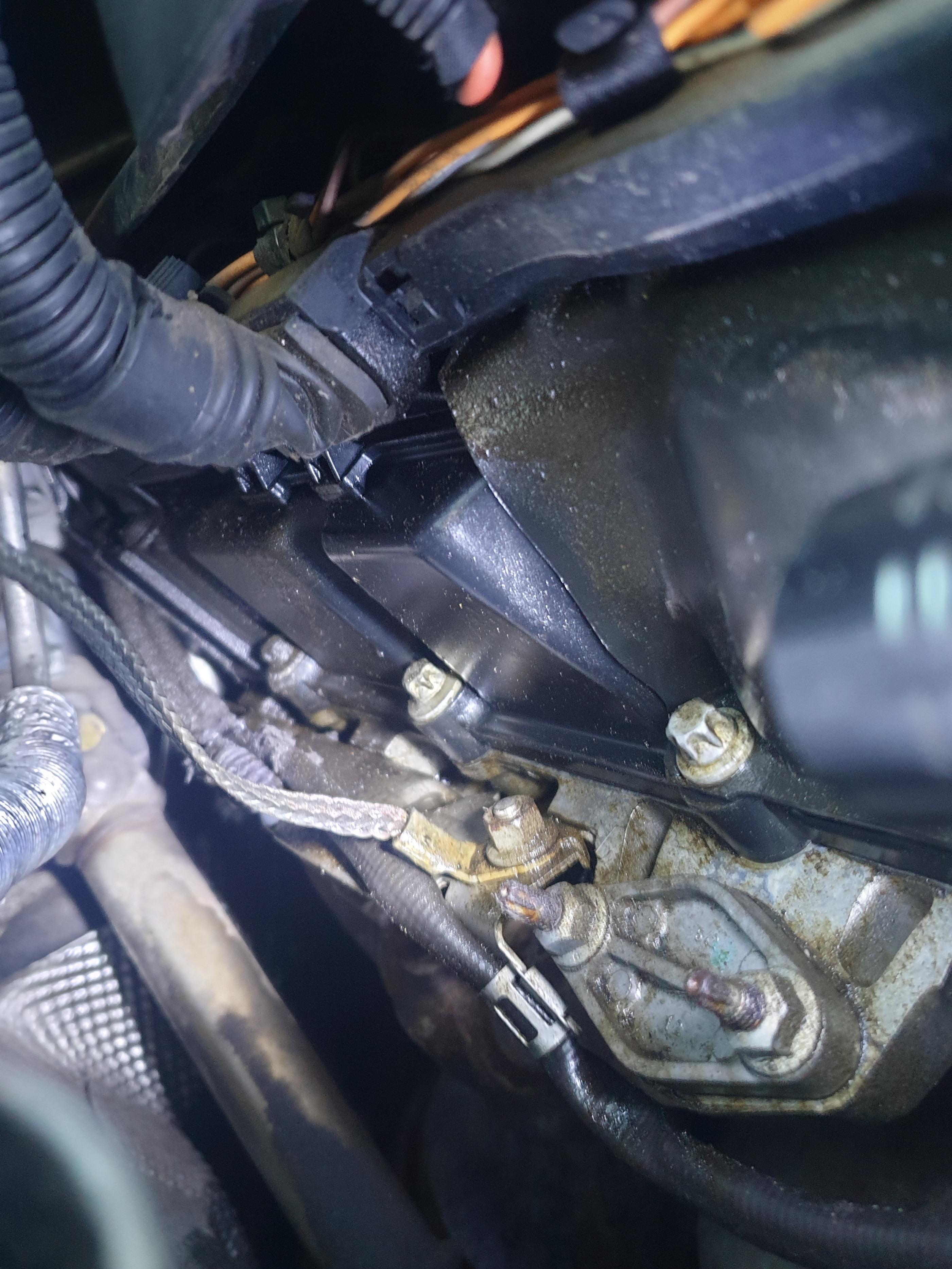

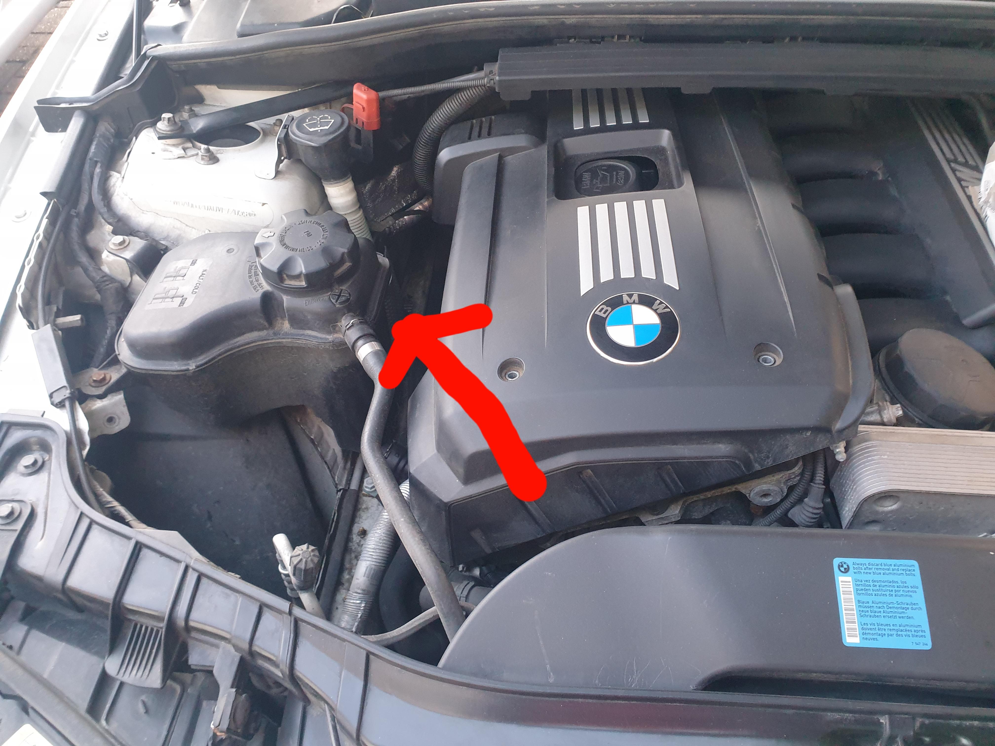

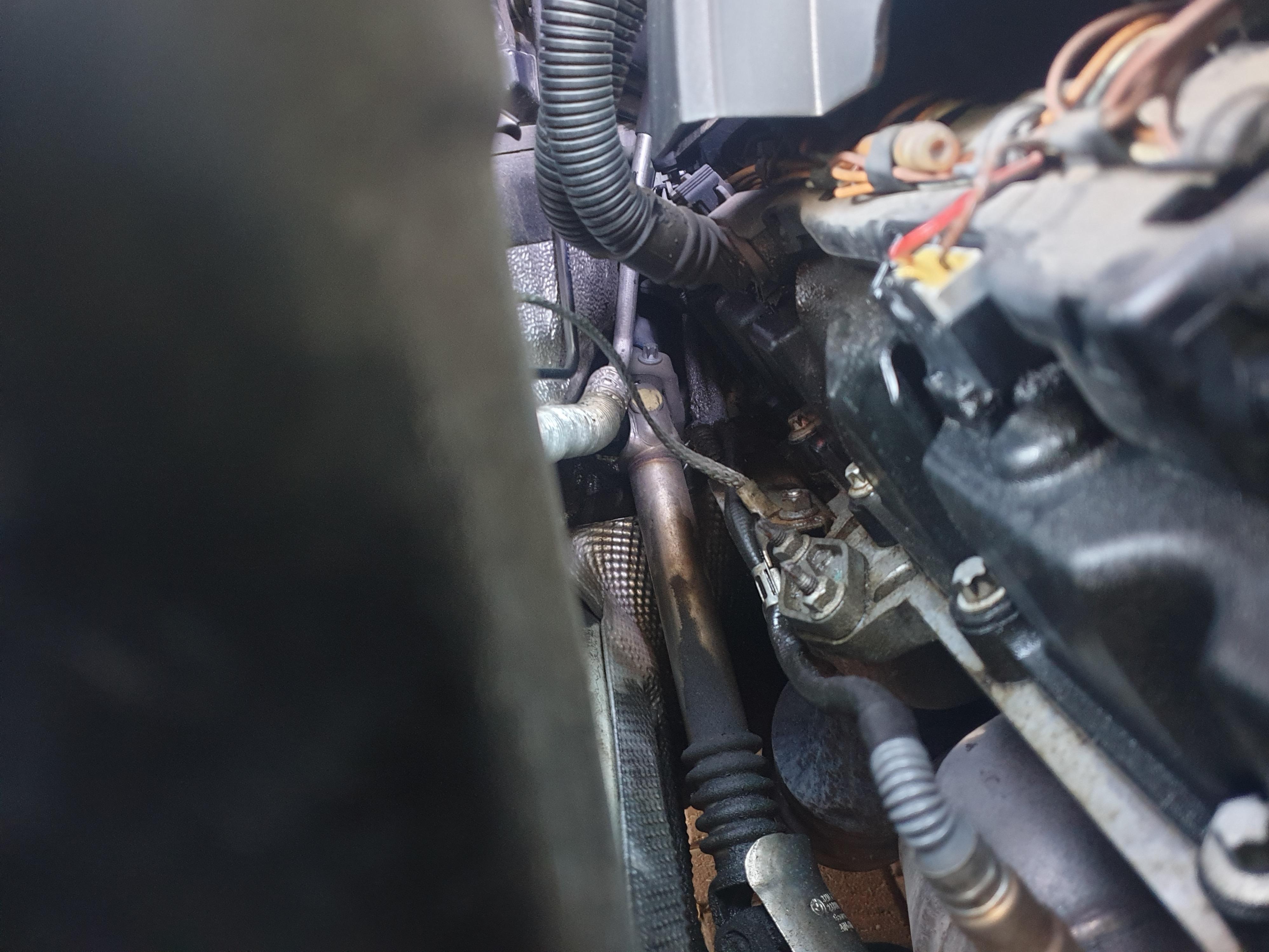

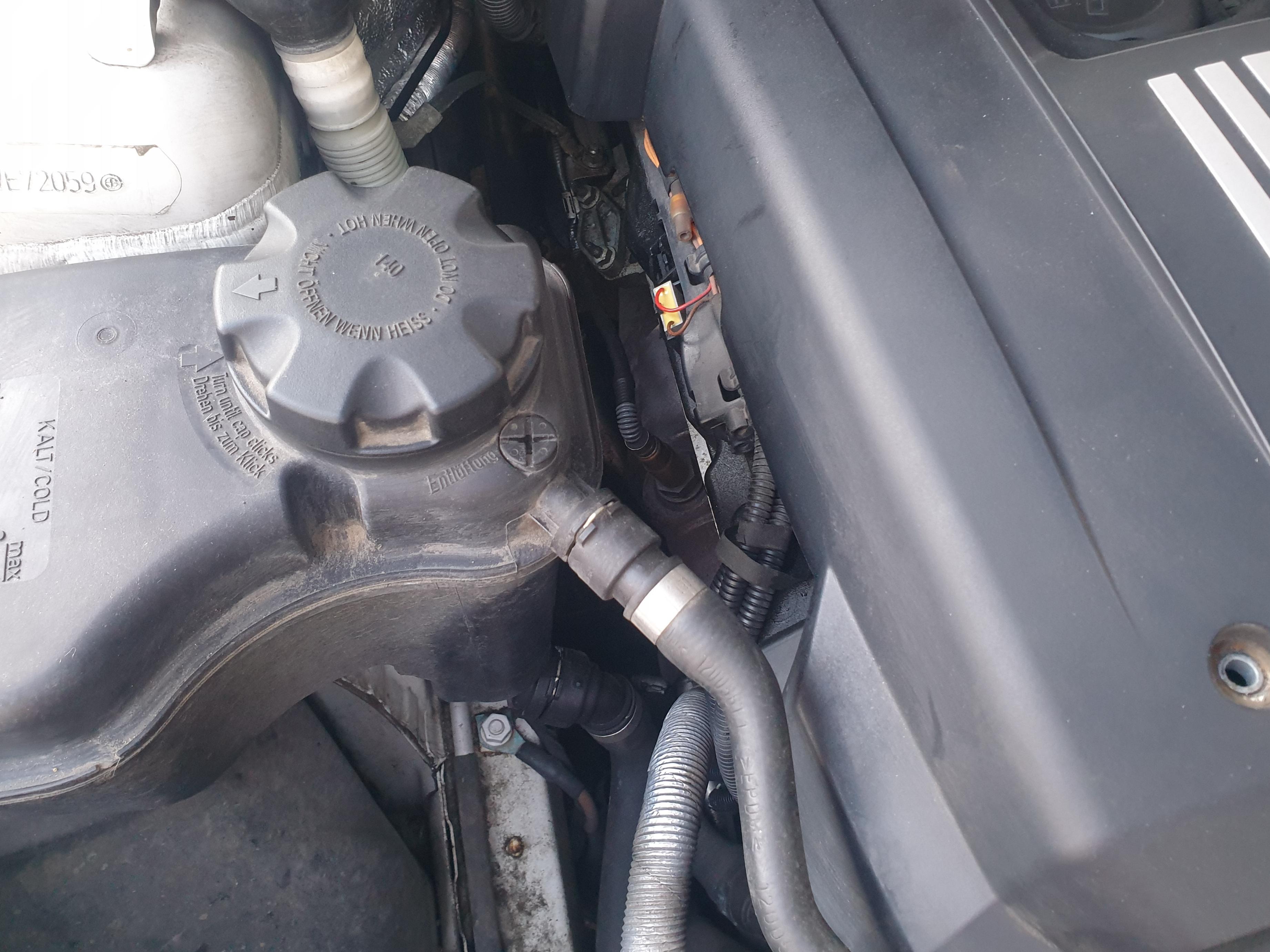

I have recently been quoted £1500 for a head gasket replacement on my 130i
So I'd like to diagnose for sure I need this work done!
I first started smelling a burning oil smell in the cabin when starting it up. But wasnt always apparant.
I took it to my mechanic, who had a quick nose underneath the hood and said it was my head gasket.
The left hand side of the engine is oily down below the coolant tank. Opposite side of the engine looks dry and clean.
The coolant light came on, and I checked the tank and it was empty.
I temporarily replaced it with water and only used it once for a very short journey, but there doesnt appear to me to be a leak in the coolant system as the water hasnt dropped.
No milkyness under the oil filler cap or on the insides of the engine.
It's done 100k.
As far as I'm aware the engine hasnt overheated. Unless the thermostat has gone.
And having read that it's very rare for the head gasket to fail I thought I would post this up to get some opinions.
Below are some pics of the area in question.
Thanks in advance for replies
Morning Daniel
BMW straight 6 engines are pretty tough beasts and gasket failure while not impossible are rare
Difficult to diagnose from pictures however here are my thoughts.
First what tests were done to diagnose the Head Gasket ? A compression Test ? A sniff test to detect exhaust gas in the Header Tank ? Any sign of water in the oil ?
Oil weeps from the rocker cover gasket are not uncommon and could well cause the weep you show. Clogged CVR (crankcase ventilation) pipes and filter could be a source of oil in the exhaust. The coolant loss you describe doesn't sound significant though any loss needs investigation, is the car used daily and does it run at full operating temperature ?
I would take it to a BMW Specialist if you haven't already, I would ask them to investigate the oil weep and see what they come up with
Good Luck
