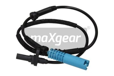

anyway. put the old w/s/sensor back on with the old oem module that actronics said they couldnt fix. and guess what? YES! it's all working like new. i can only imagine that there was a fault in the mod then i compounded the the problem with this dodgy w/s/sensor. it must wired in reverse?? fingers crossed, Done 30 miles today, all good. 'maXgear'! should have gussed from the name. i feel a bit foolish.  Thanks for your help anyway

ABS Wheel Speed Sensor For BMW:E65 E66 E67,7 34526761650 34526771708 34526761800
Item price £33.79
Quantity 1
Item number 174244238586
Delivery service Other courier (3 to 5 days)
