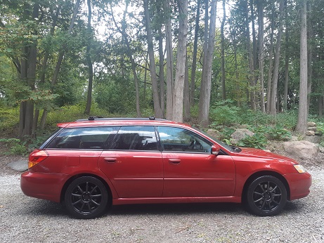

I am from a Subaru world - I'm on my 5th a 2005 Legacy GT wagon 5MT 280,000km

Hi Clive
Nice looking Legacy, my wife's car is a 3.0 Outback with a full Perrin Engine upgrade now on 140k miles, 400+ whp is addictive 😈 Porsche's are easy meat.
