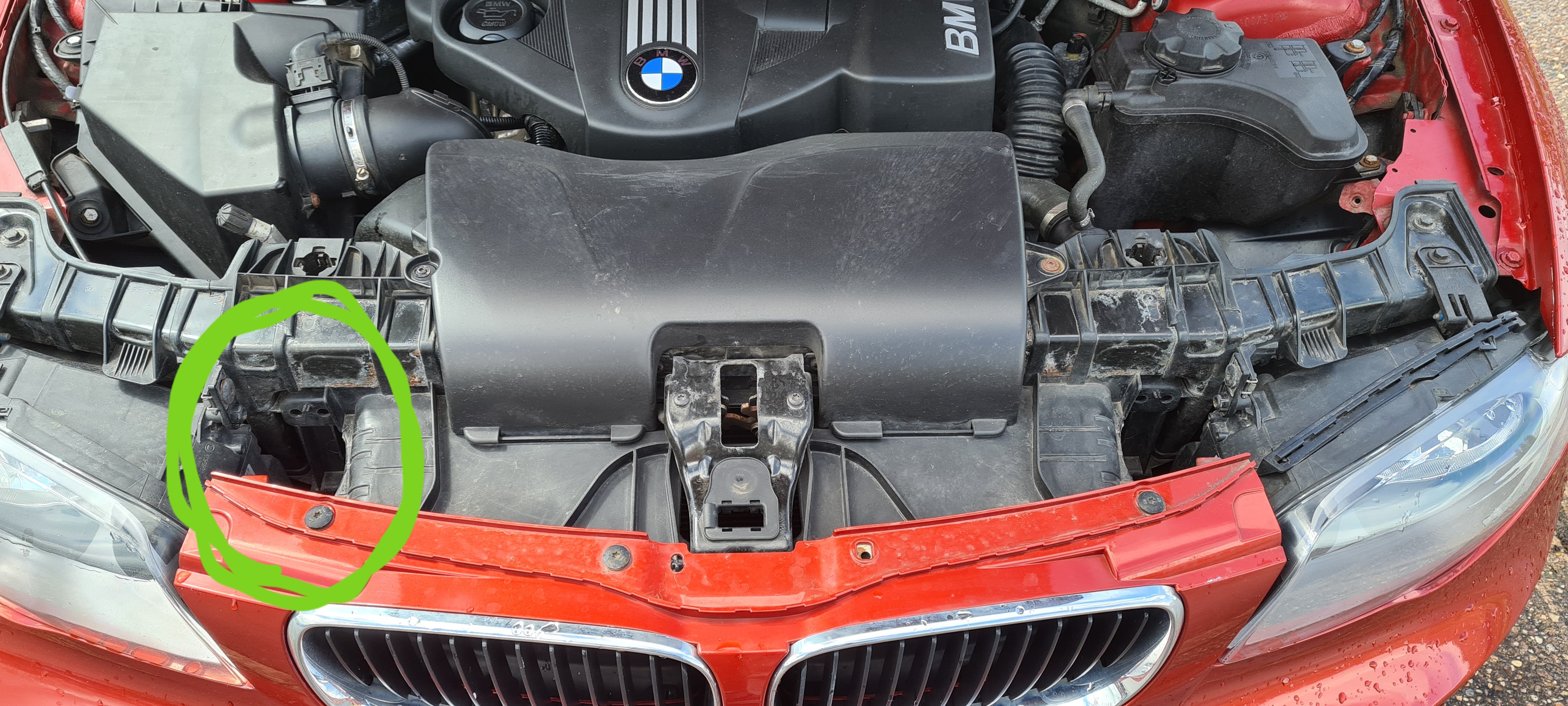

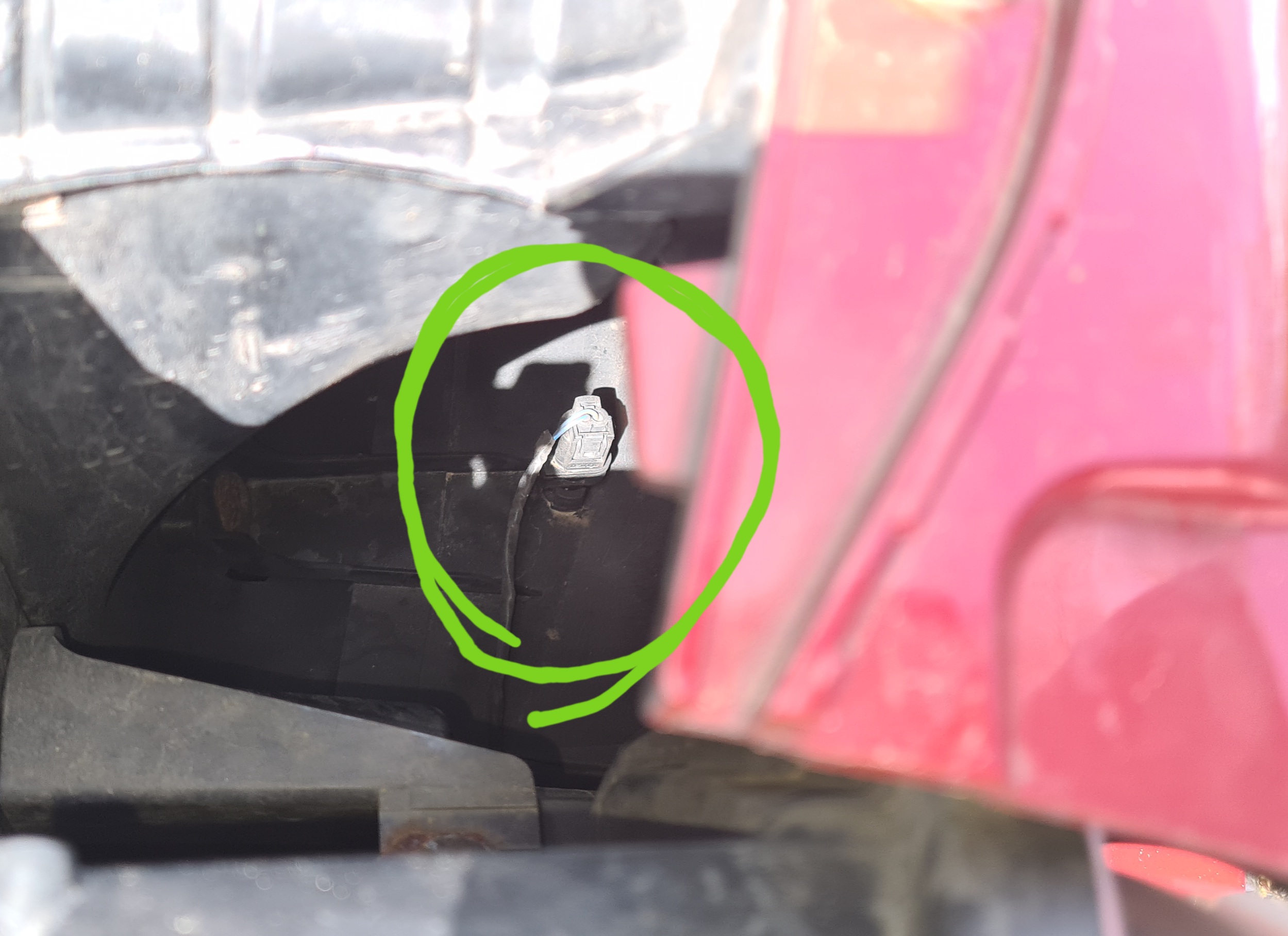

Hey Russ,
I was wondering the same thing, I found it on mine (2009 1 series) if you open your bonnet, look to the left and there is a small gap to which you can see the back of your front grill, you will find the sensor down there, I'm not sure if it's the same on the 2011 model.
Hi Rak, thanks so much for the photos.... thinks it’s pretty much the case and further investigation yesterday revealed a couple of things!!! So... I found that the engine under tray comes in 3 parts.... the Center parts there, and the passenger parts there but found that the drivers small part is missing,,, hence why I’ve not been able to find it and trace anything back!! Lol
so ordered a new sensor but now comes the mission of finding where it’ll plug into once I’ve set it in position!! Don’t suppose you remember where the wire loom goes to or what the plug looks like that I should be looking for!! !Removed! joke!!! Haha
