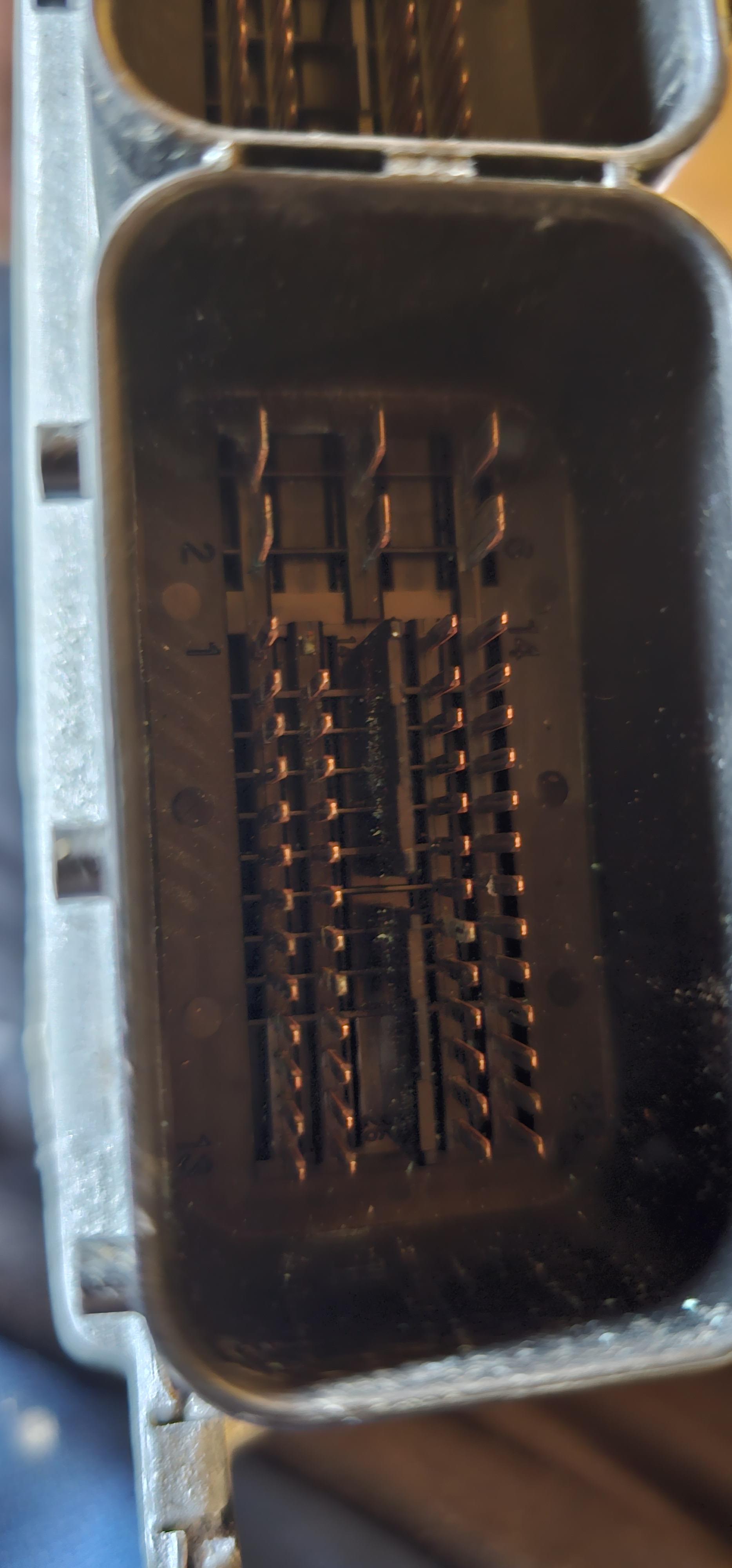

Little update, took my ECU out for a 2nd time to observer the pins as I had not originally and had found a broken pin. Would this correlate to what my problem is? If I need a new ECU, would it be easy to swap in and out or what I have to get it programmed from a dealer?
Morning Devin
I believe if you change the ECU you will need matching EWS Drivers door lock Ignition barrel and Keys so quite a bit of work. Much better to get your ECU tested then repaired if you can or if it even needs it.
