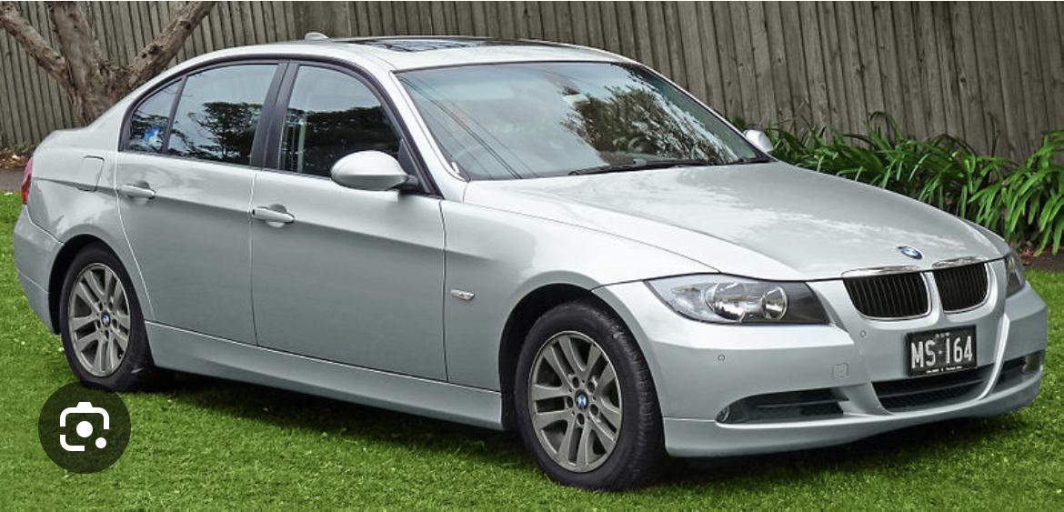

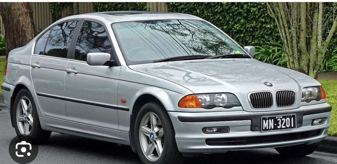

Hi Steve. Can you post a pic of the car?
DC01A283-0B83-4CAD-89A1-E33561B96C0E.thumb.jpeg.c6431660e4a7588c928292ca0b496022.jpege46 saloon
4399F06D-348A-4C6D-9558-D42F616E7D34.thumb.jpeg.cfcf97a3bfb1bd5a98a5b3713984ca2e.jpege90 saloon
@greydog will be along soon with what you need. 👍🏻
Morning Steve Morning Stu
Welcome to the Forum Steve
Go to www.realoem.com put the last 7 digits of the cars Vin into the search box it will bring up the exact model so then you will know for sure E46 or E90
I believe the engine is the same in both models N46 but due to emissions changes the Lambda sensors are different a look at the exhaust system may give some clues if you know what your looking for. If not stick with realoem then order using the part number that way you will get the correct ones for your car
Good Luck
