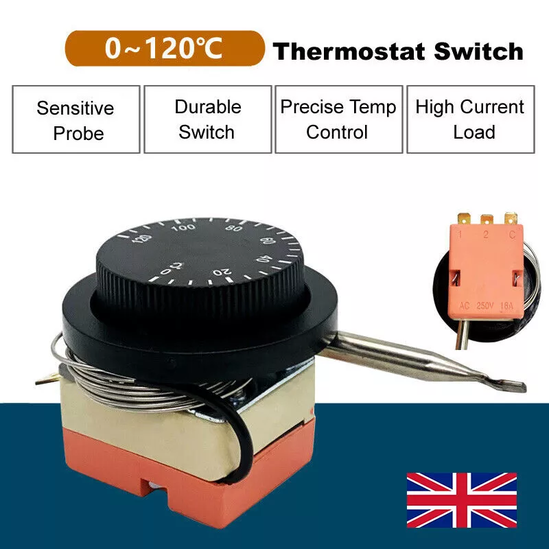

There are Fan control thermostats that fit into the top of the radiator, just take the hose off slide it in replace the hose and tighten the clamp. Most are temp adjustable so you should be able to get where you want to be. See attached image

As for the electric thermostat, I am aware of this one as I am using it on my 69 MGB for the electric fan conversion.
