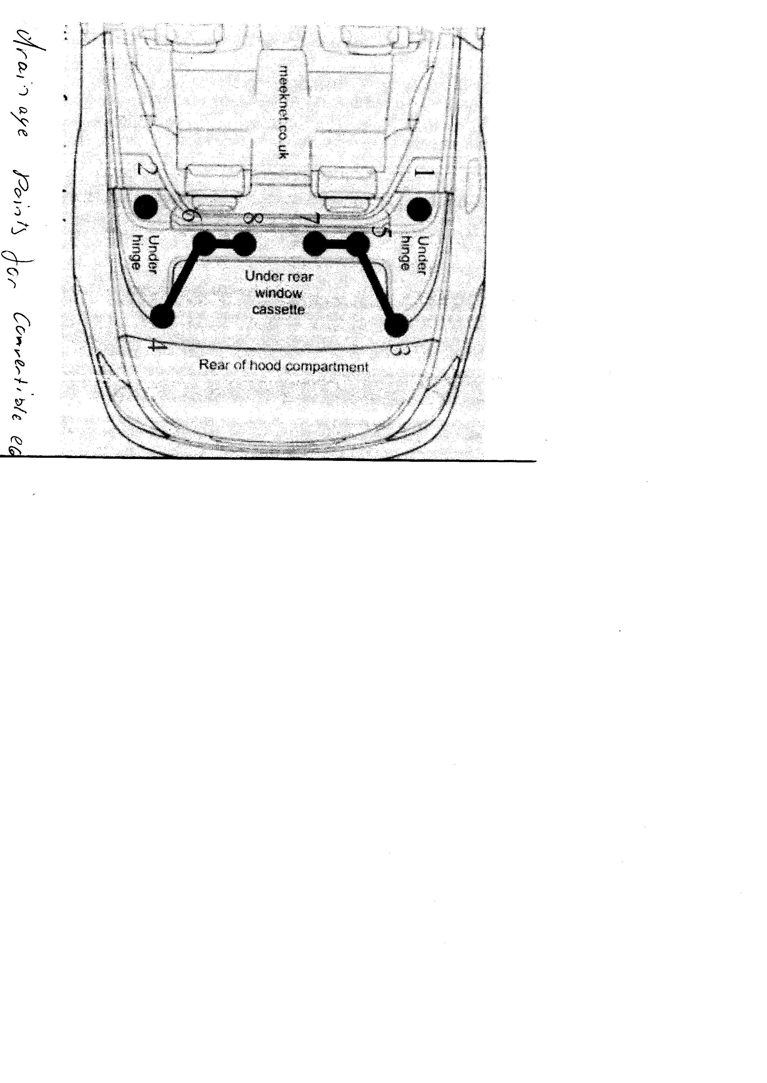

My local BMW Dealership printed me off a diagram showing the 8 drainage point locations but the apparent amount of carpet etc that I have to shift for access is a little difficult for me !
Have I misunderstood, and the drainage points are actually beneath the little black button-tops that are visible when the boot lid is raised ?
My local BMW dealership has quoted me £162.00 incl VAT to clear them and reckons that it is a one-hour work.

I have a print-out from the main dealer showing the location of the drains.
Perhaps I have misunderstood the diagram, albeit I have had the hood in the partial open/closed position several times and cannot see any drain points.

Looking at the diagram I would say hood up boot lid open and the are in the Hood starage area. Not much help I am afraid as I have never had to explore this issue I would be more concerned about where it is getting in than letting it out

Ok , I agree with the BMW drawing although yours and mine will be different, the locations look familiar. I don't know the Ci set up but I have never had any water getting into the actual car cockpit, only the soft top stow away area, served by the drains. This stow away area is not carpeted either.

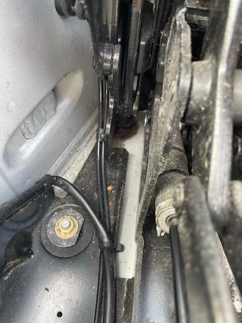

pic 1 - back corner of the storage area - 1 each side

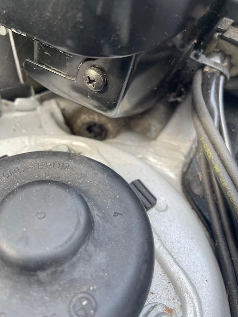

pic 2 - literally adjacent to the rear strut pillar

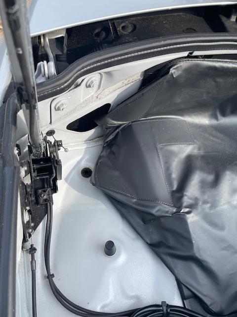

Pic 3 - rear corner nearest to the rear of the vehicle right side

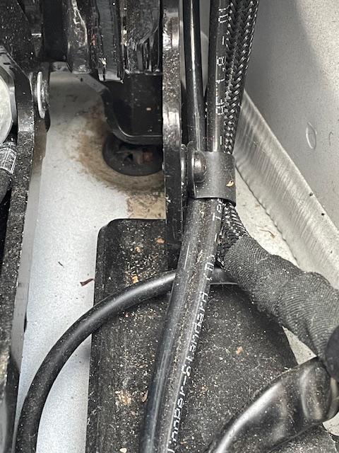

Pic 4 - as above left side

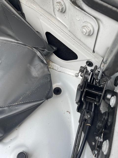

Pic 5 - same as pic 1 but other side - this location is tucked right back immediately under the folding brackets.
I am not aware of any other drains under that protective cover as that does not lift up. There have been times I have had several inches of water in there sloshing about but none has actually entered the passenger compartment. As I said I do look to blow through these drains on a regular basis.
Hope this helps.
Hope this helps.
