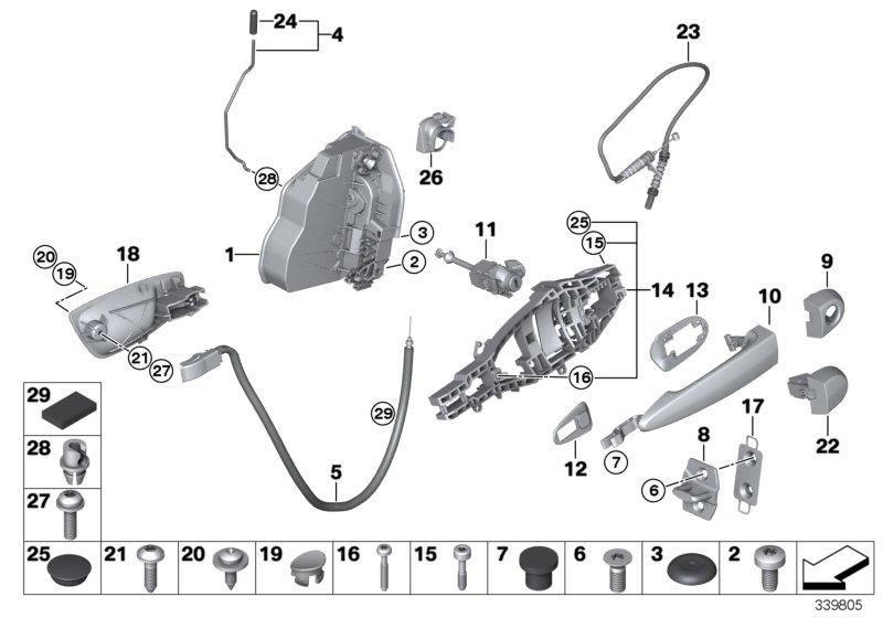

A drawing a pic attached hope the help Your aiming at the little hook shaped lever in the picture

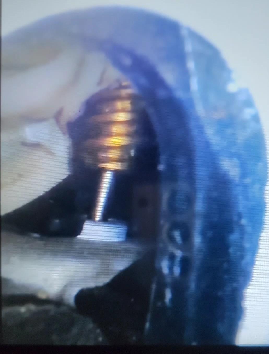

I think I found the problem but I don't know what that part is called and how to get to it with my door stuck shut

Take a look at www.realoem.com put the last 7 digits of your Vin into the search box it will call up your Model the look in the Body and Trim sections for what you need. The site is an online BMW parts list as used by dealers when you have the part number double click it and it will show a list of alternates and other models it was used on
As already said from your description the actuator has failed (no inner or outer handles working) I have seen several over the years. There are 2 ways I know of to get the door card off (1) with the door shut the drivers seat needs to be removed or tipped on it's side and then yo can lever off the door card as the door is closed you will break some of the plastic clips so have spares ready. This will expose the door inner skin and the lever that attaches to the inner door handle operating cable. This is the lever that needs a wack to open the door. Method (2) lower the window prise the door trim away along the top edge and back edge (lock edge) you should be able to get enough space to see the lever with the cable attached on the inside of the door, put a long screw driver or pry bar on it push it down and give it a good wack. Life will be so much easier with the door open. Door card off peel back the membrane carefully undo the screws holding the actuator pop out the door button un-hook the inner cable and remove the actuator .
The actuator is the Black part in the photo you can see the small lever and part 1 in the diagram

Not sure but the only place I can think there would be a worm drive is inside the Acctuator !! At a guess someone has been there before and broken away the plastic cover.
How did you get the picture ? is the door open or have you got the door card off ? Seeing that you really do need a new acctuator
That worm drive turns a nylon wheel that operates the door lock how you will turn it now? I haven't a clue but that part should not be exposed.
I used a camera on a scan tool. Door not open yet and door panel loose but not off. I will update you soon. We are going to junk yard to take apart a door there so we can see what's in there.

If you reached that far to take the picture you were just beside the internal door release lever (metal lever with a hook end) just put a long screwdriver or pry bar down between the door card and door push the lever down to it's limit then give it a good wack the door will open
