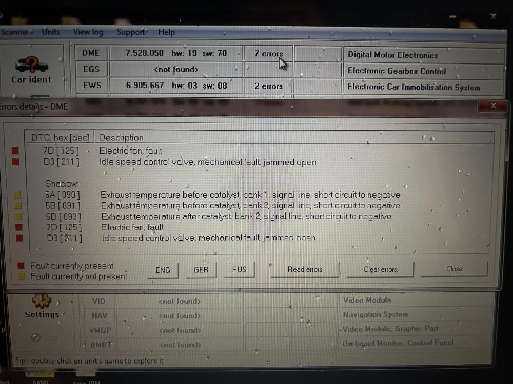

now drops into fail safe and says the idle valve is mechanically stuck open.
where is it, how much is it… can I kick it?

From memory it is linked to the Air Pump and Vacuum control system. Find the Airpump and follow the Vac lines to the rear of the engine you should find a valve with a plug on top (or end) first make sure all lines are good no splits or cracks check the valve is operating, dont forget there is a non return vale in the system close to the inlet manifold.

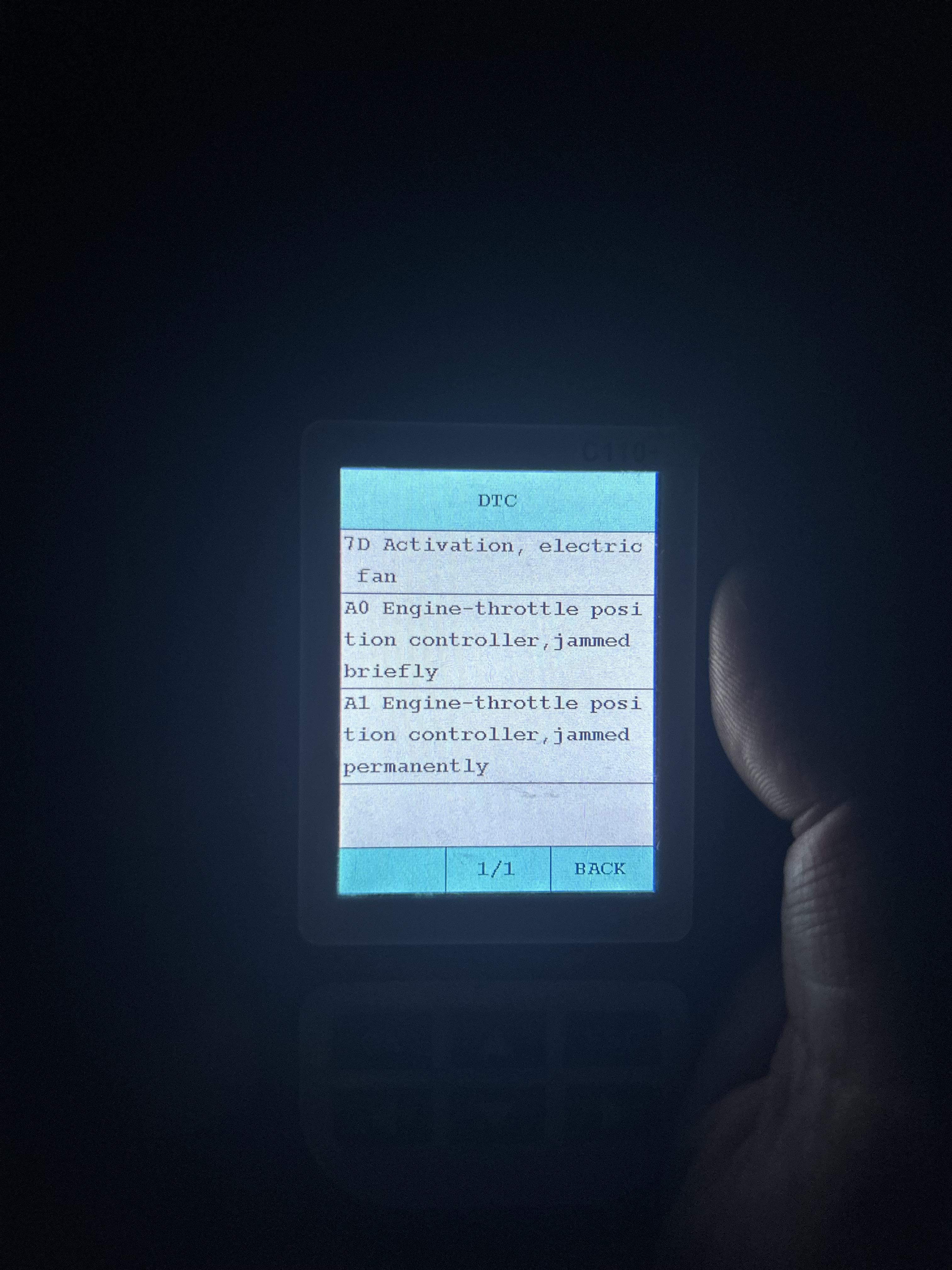

Got home and the revs are all over on idle. Little scanner showing the throttle position controller jammed…
it’s so far had a new throttle body, new idle control valve, new battery,  new maf…
