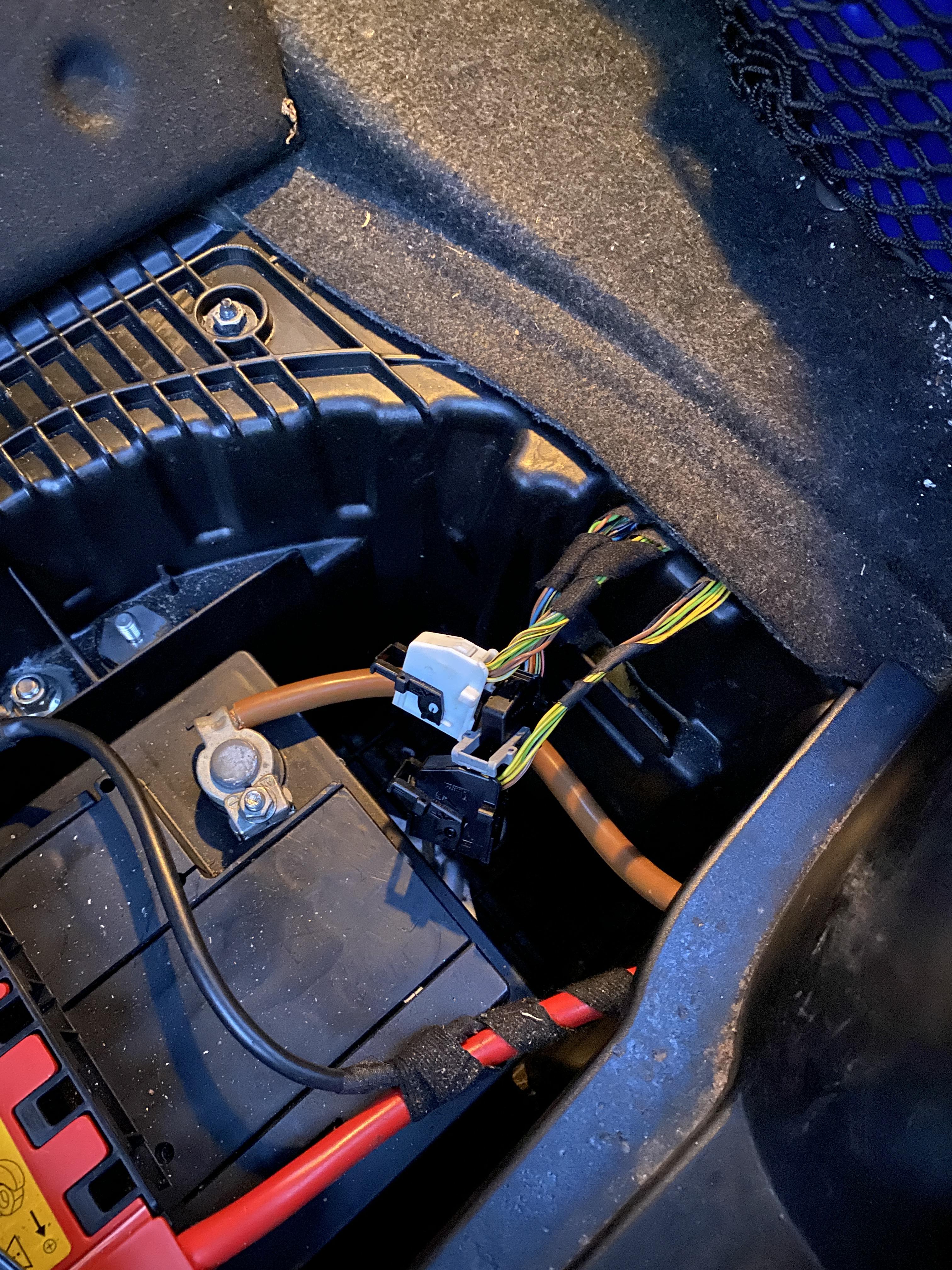

Hi - I have a 2007 1.6L Petrol 1 series and it has wire connectors in the boot near the battery but I don't know what they are meant to connect to. Are they just spare or is there a part missing?
The car currently not starting but we think it is a BCM fault but just wanted to know what the cables in the boot are meant for.

Morning Andrew
looks like your missing a module rear camera or PDC could be a Towing Module

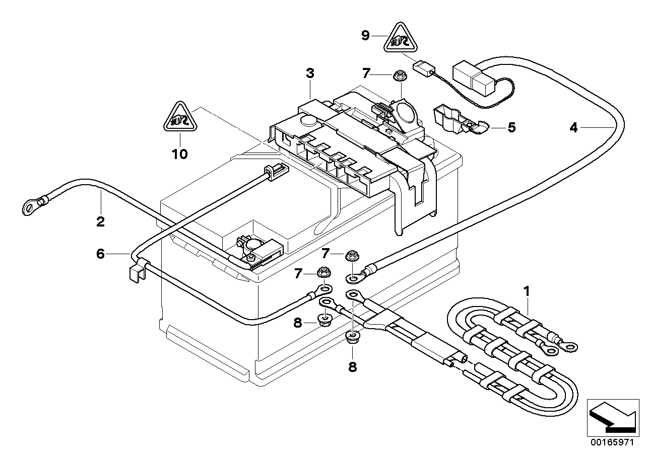

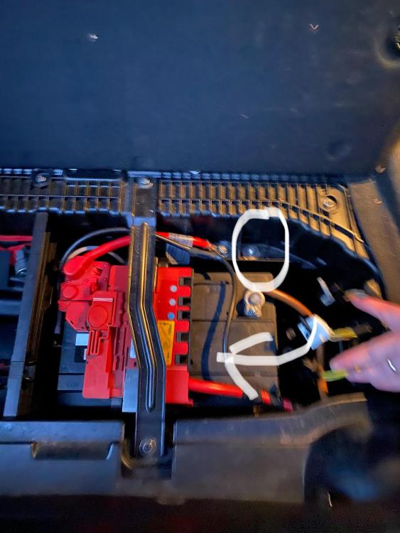

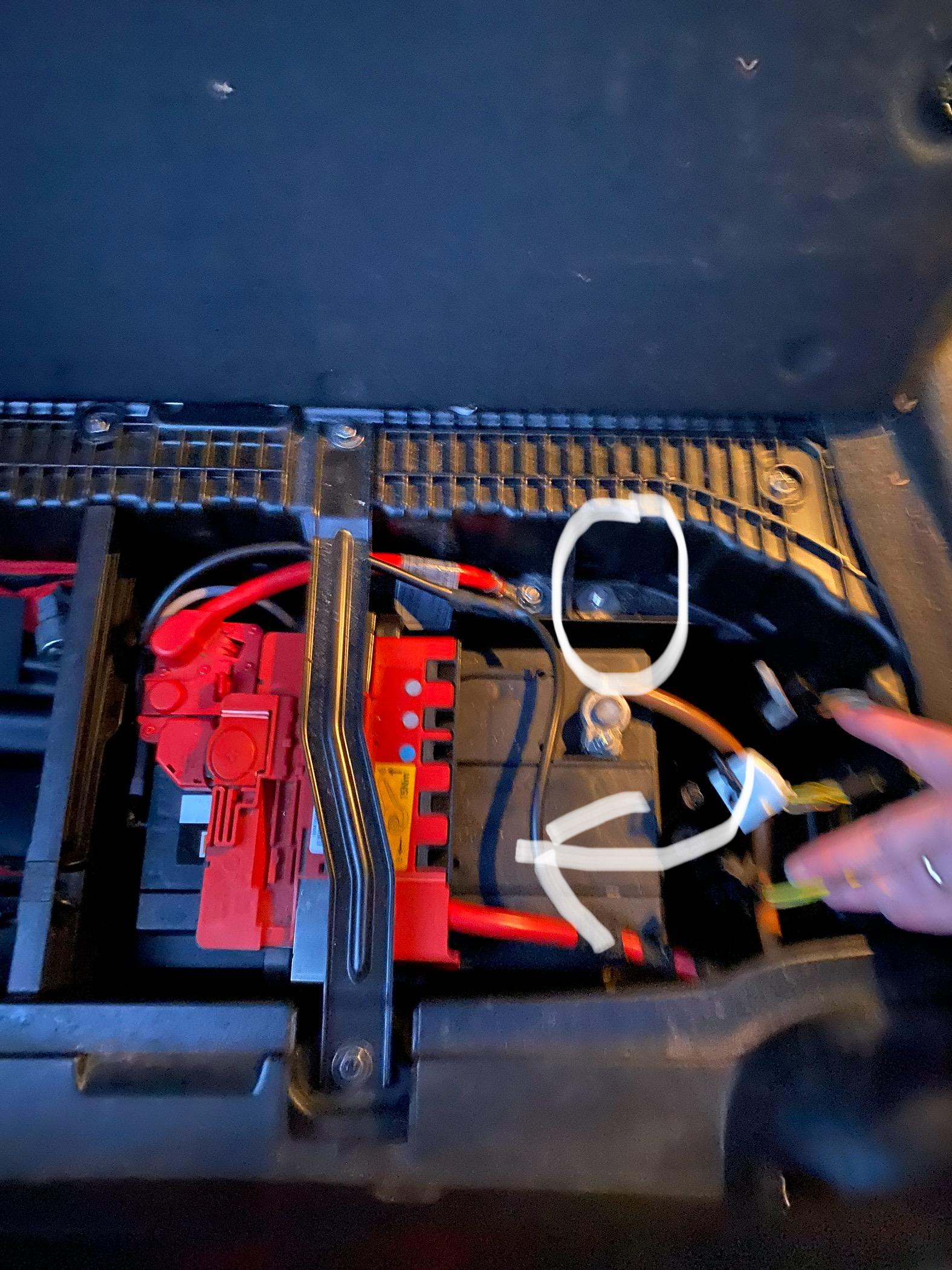

Thank you. Do you know if there is a red cable missing as I have seen it on other 1 series?
Morning Andrew
The attached drawing is from www.realoem.com it seems to show you are infact missing a connection (item 6)
  • Thanks 1
According to www.realoem.com the part is
06 Positive battery lead   1     61126929715
Looking at the drawing it connects between the power lead right connection in your Photo and the main power distribution on top of the battery arrowed in your photo
