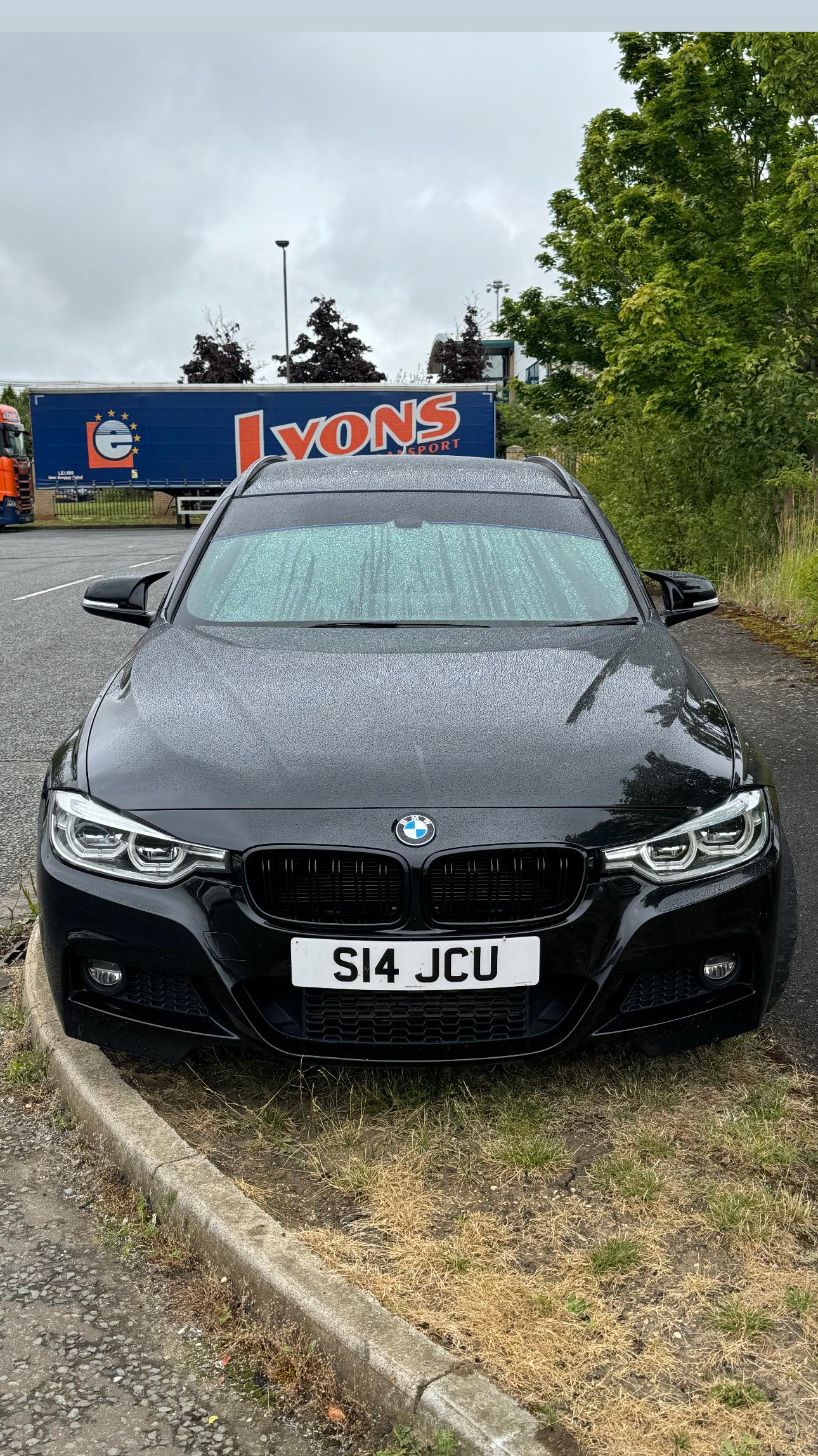

Recently had an error message saying drivers side main beam failure, along with high beam failure. The outside light on the drivers side now won’t illuminate ( when unlocking it flickers on then off). Wondering if it’s worth a new headlamp entirely which I know can be expensive, or if there is any other alternative fix? Pic of car for reference. TIA
