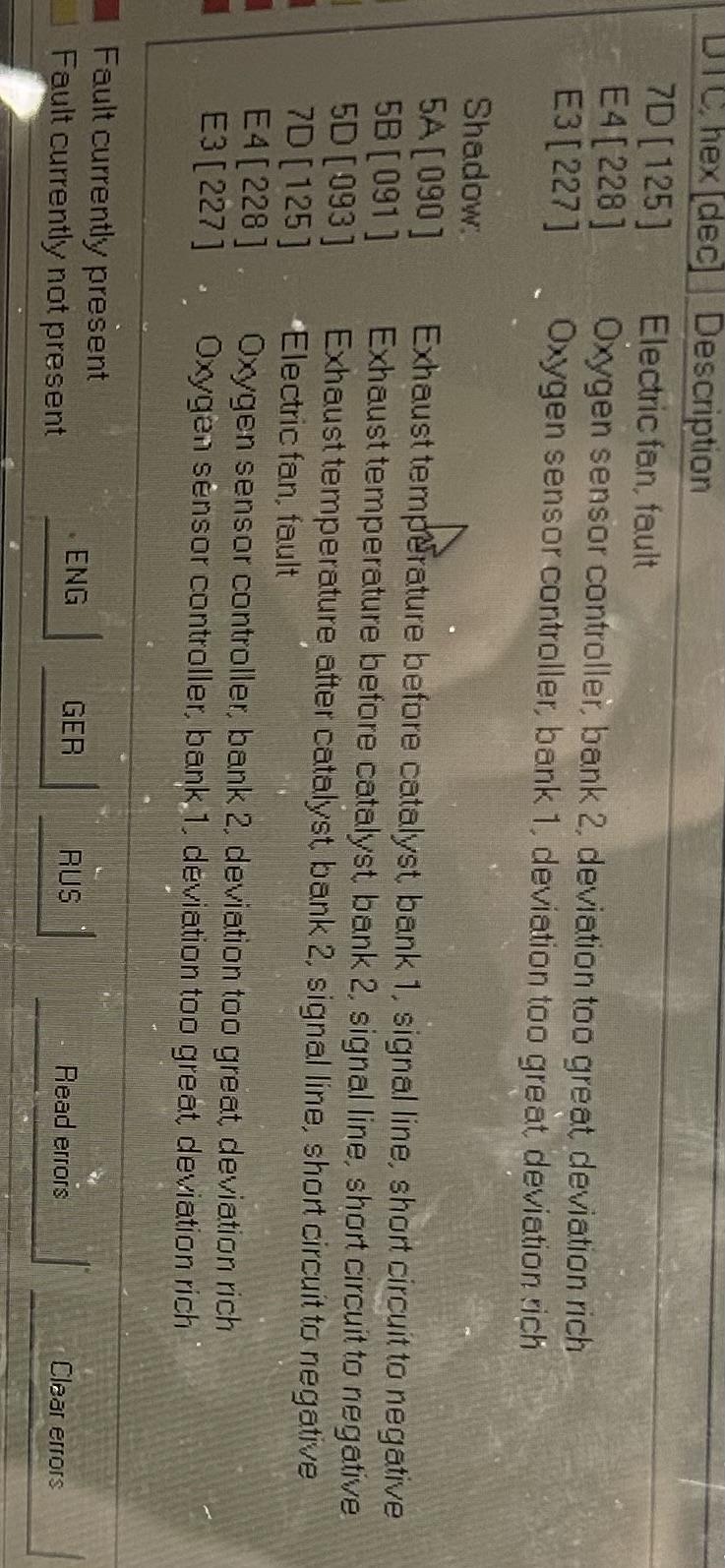

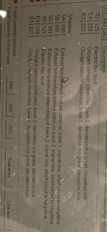

Right… hooked the computer up and it’s saying bank 1 and 2 deviation too rich.
live feed seems ok and oxygen sensors seem to be stable and adjusting with each other at the same rates.
Little bit of a head scratcher for you Stu
