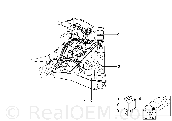

Relay at a guess
If it is the relay, yeah they wont work when removed and you can just replace it.
I was thinking earlier, I dont think it is the relay, as there has to be power to the relay for it to work.
What im saying is, if its switched off at the stalk, and there still on, it wont be the relay, it will either be a switch problem in the stalk
or a wiring problem between the stalk and relay.
