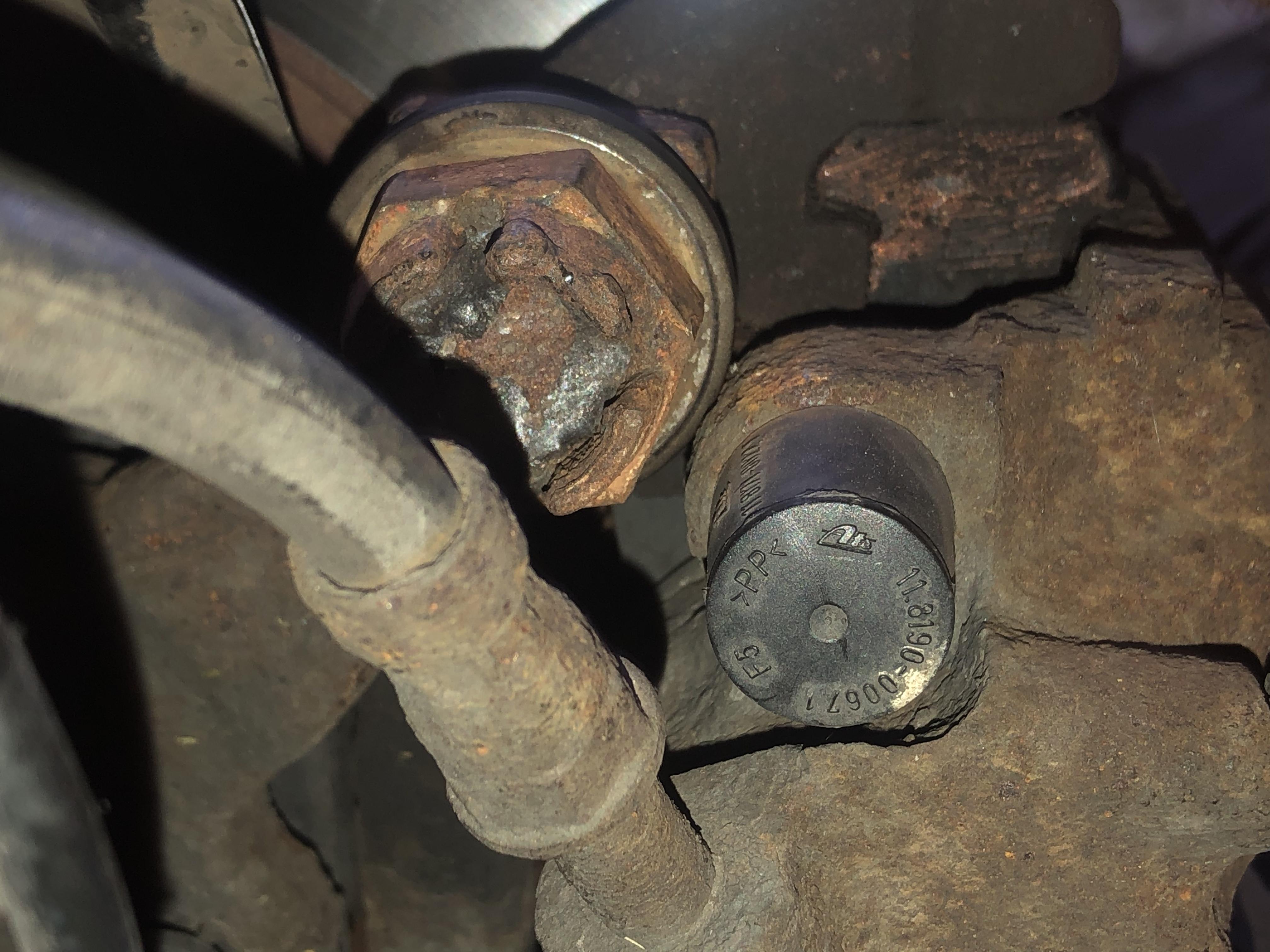

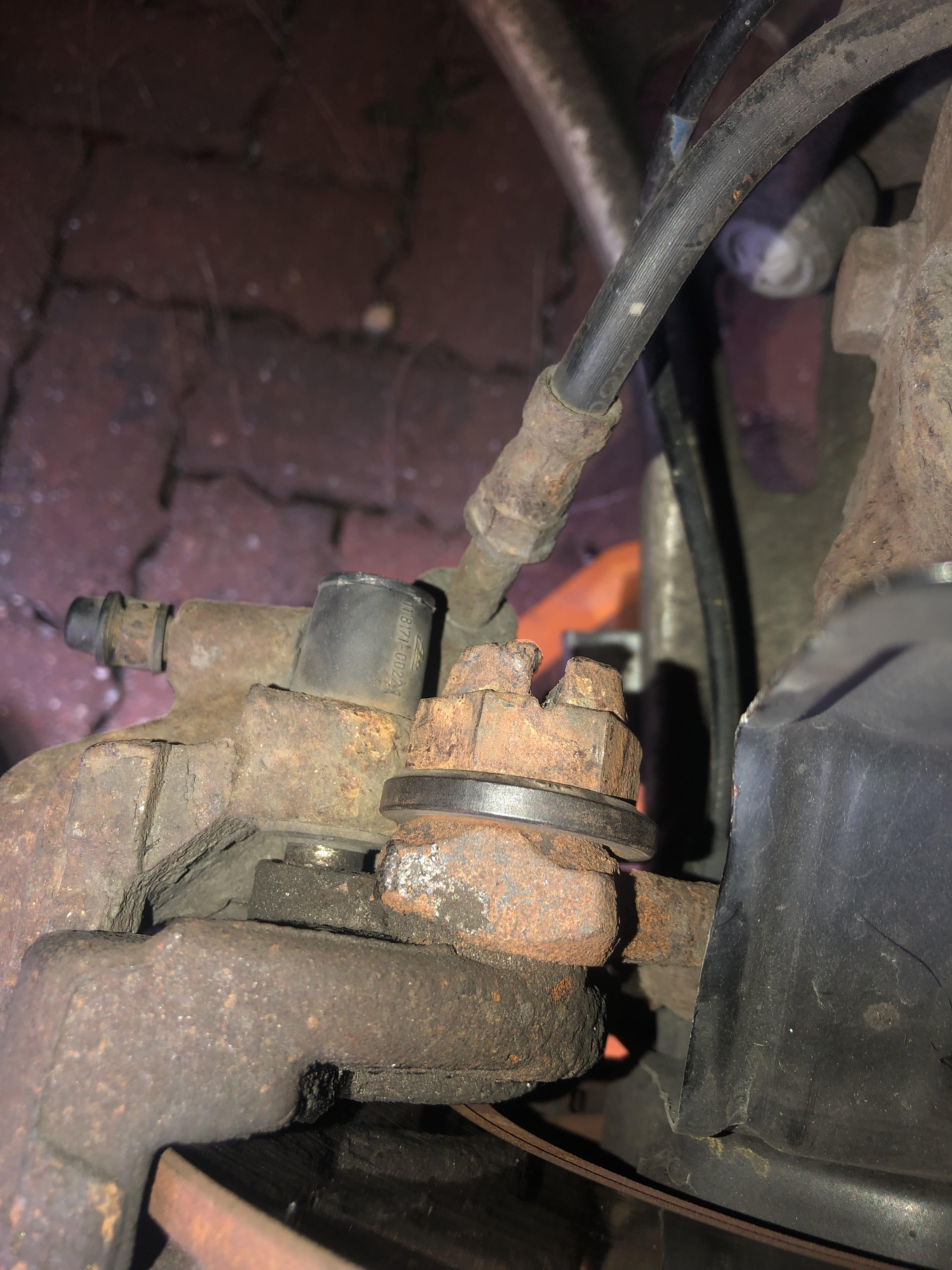

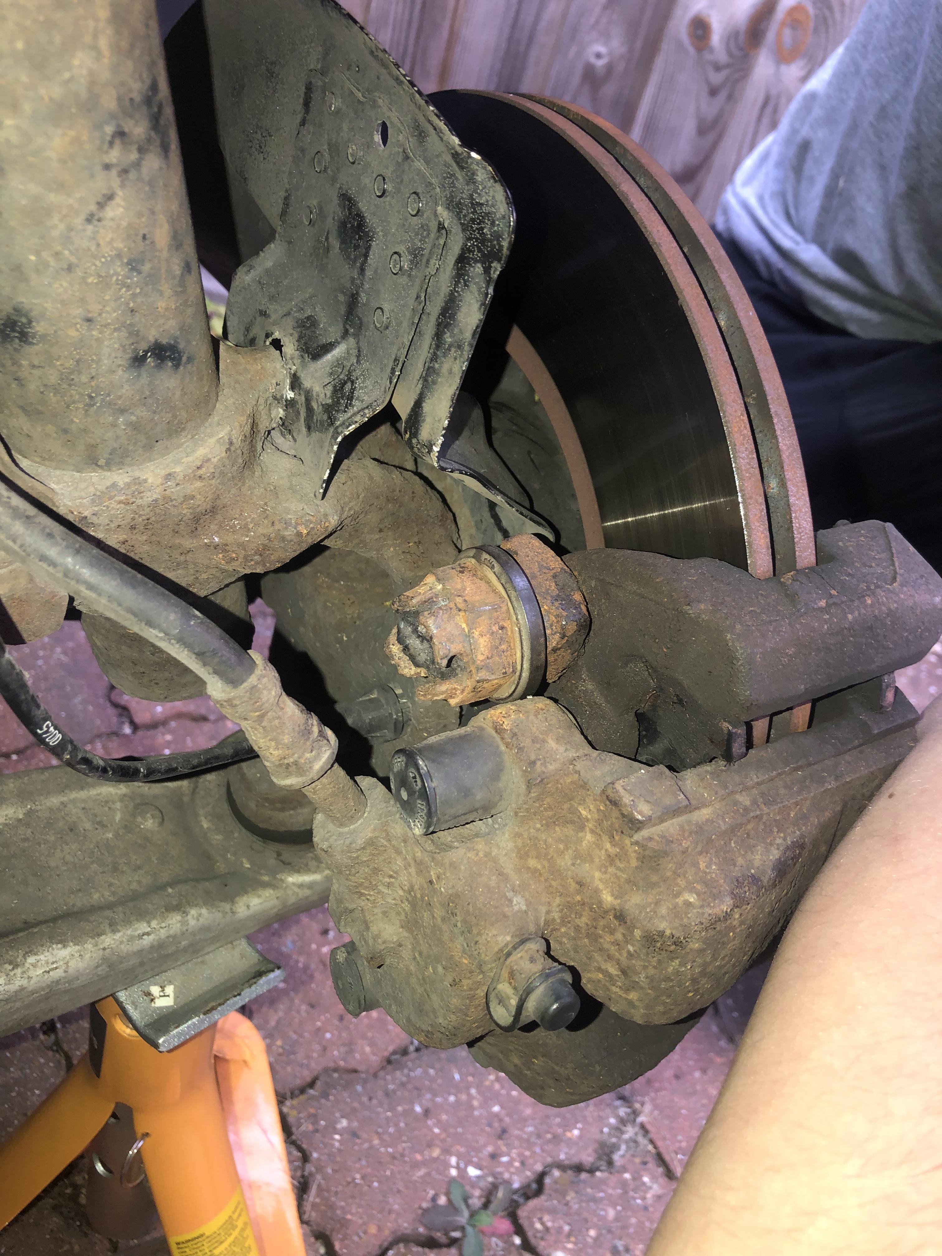

Hi lads, new to the forum and in need of a bit of help.
Familiar with mechanics and basic work.
Rattling coming from my 320, drivers side calliper area. Pretty sure it’s a strange washer that’s sat where the calliper connects to the strut of the car. Was expecting to see 2 bolts and unsure what the washer shaped piece of metal is supposed to be doing (due to it not existing on the passenger side).A51D4DF5-75A9-4988-A0A9-16DE57732A55.thumb.jpeg.96058842893d905af44b3956ce104153.jpeg
Also looks like someone has gone heavy with the welder on the back of the nut.
Any help/pointers will be really appreciated.
Ash
Welcome Ashley
"BODGE" how horrendous is that!!! Take a look at www.realoem.com put the last 7 digits of your vin number in the search box and it will bring up your model, then look in the relevant section. The small exploded drawing will show what should be there plus the part numbers for replacement. With luck you may be able to soak it in penetrating fluid and undo it, fingers crossed the threads are sound and it will just need replacement bolts. I would do both sides to be sure plus check the rears seeing as you have discovered"Bob the Butchers" handiwork.
From the picture I wonder if they have bitched the head of the torx bolt and welded a nut on to try and fix their problem?? You should as you say have either M12 bolts or M12 torx bolts
I believe BMW only sell/use the torx head bolts now
Also check www.newtis.info this one is a BMW online technical information site that is the same as the information BMW Dealers use.
Good Luck
Let us know the outcome this certainly isnt a common problem
