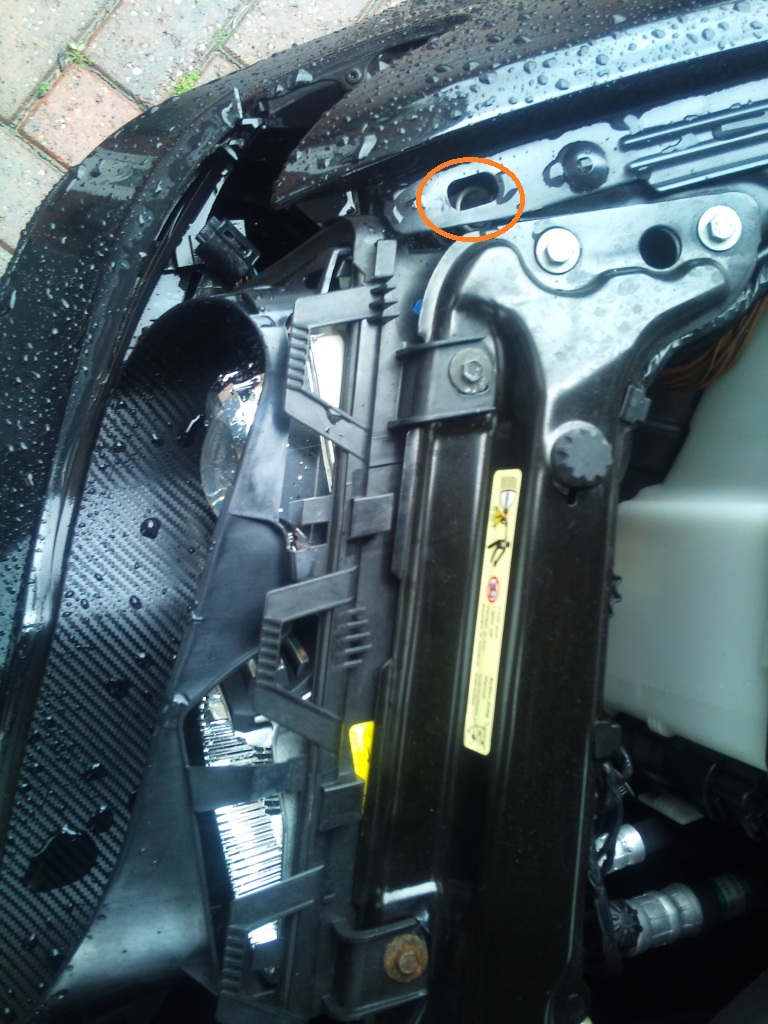

If its pre facelift. You need a long screw driver or stick. Look for a hole in the wing inside the engine bay. Stick the screw driver in there to push the clip together then slide it out. Easy as

my pic I added is post face lift, not sure if its different
Just looked at the pic don't think mines got that hole, is there another way to take them out easily or does the headlight have to come out first?
It should have a small hole. Shame im not on my laptop as id do a pic for you
The pre face lift not the same as mine then Andy?
