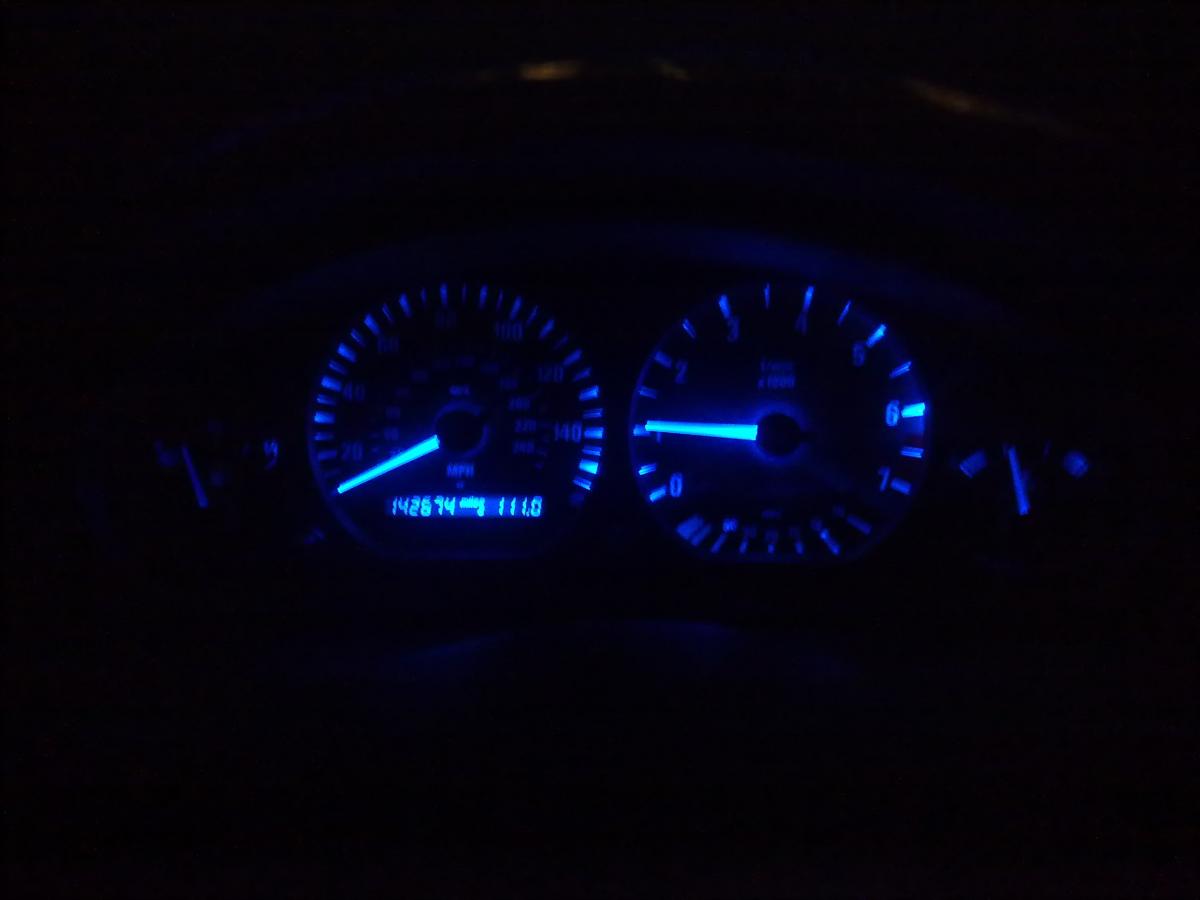

They look alot nicer me and me wife spent a couple hours with a Stanley blade and scraped the orange of all the numbers and stuff we got couple sore fingers lol but well worth it
Post a pic up of it and I'll post a pic of mine ;)

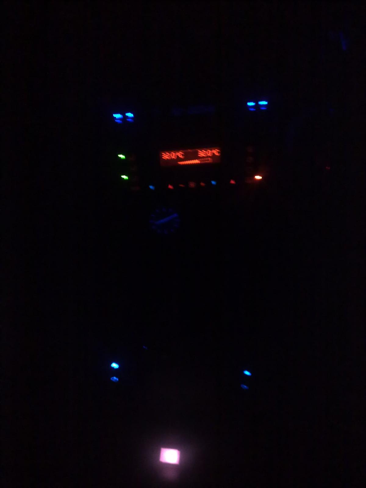

Hers a couple pics of mine,just wish I could find a way of changing the climate control too :)
TBH Dave, it's just LCD with back-light so it should be just a case of changing the bulb(s) :)
No such luck mate,they are proper tiny LEDs and the only way to do the colour change is to break the current LEDs carefully and solder new blue ones to the legs that are exposed when breaking the old ones,and theres flippin loads of them :( I soldered all the switches ok but this is far to precise for me to do,plus my iron only has a medium sized head and this job needs a tiny one.So id rather buy one already done or pay somebody to do it :)
Yeah just looked, very tiny !
