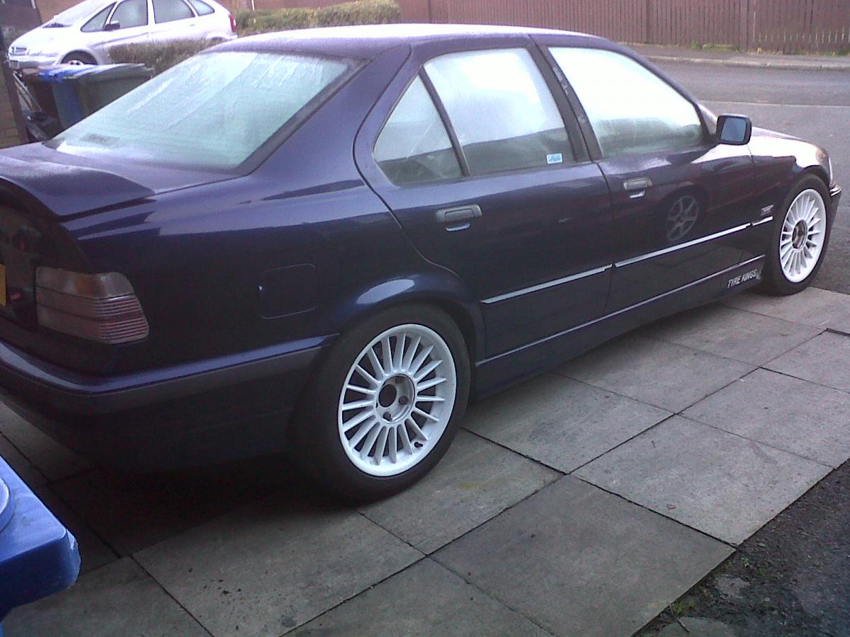

I have just bought a 320i SE (1994) the ABS light comes on after driving a few meters, i understand this means there is a fault with a sensor... does anyone know of a Mobile Diag company in the Preston, Lancs area...
The car has no MOT at the moment hence need someone mobile, i have priced the ABS sensors and found a place for less than £25 each....
