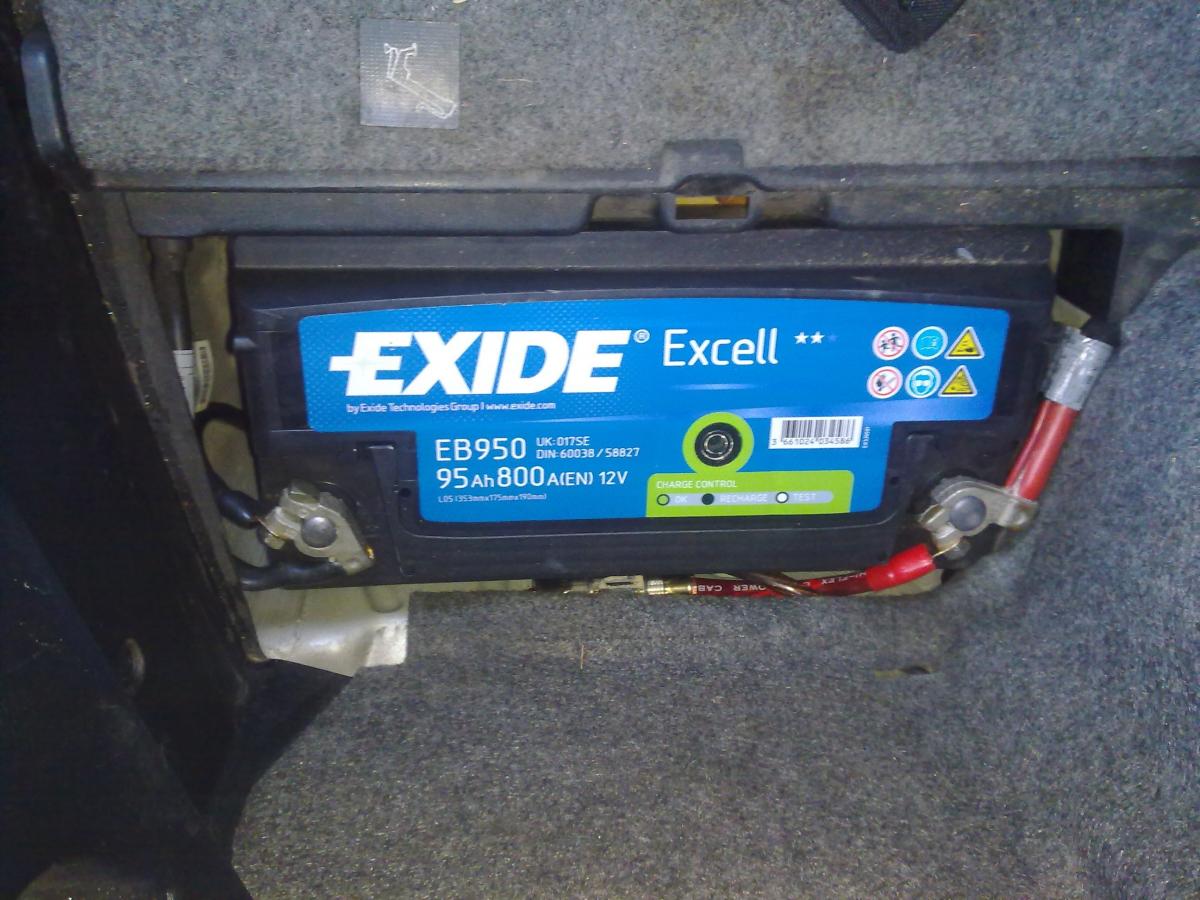

Ive mentioned my mammoth battery on here a few times now,but finally took a pic of it,never goes flat even with all 3 screens playing,plus amp etc etc and always starts 1st time all the time :) here it is .............the previous one was half the size
mine is the 325 6 cyl and mine is an 80a n never had a prob talked to mate who runs banner batterys uk and he said u need an 80a / 90a battery cause of the size of the engine
I have a small one too MrMetatarsal =(
I filled the gap by squeezing down a 1liter oil bottle =p ( bodge it 'n' leg it )
Iv got twin subs, 3 amps and a bass cap with a screen too but iv never had a problem with this battery.
