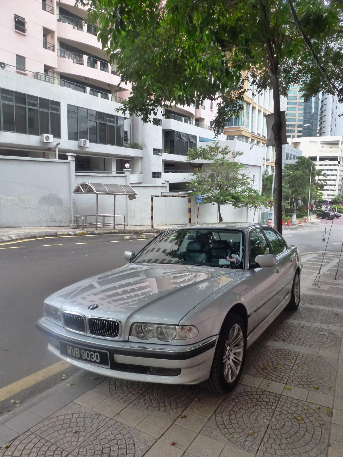

My 728 (2000) automatic occasionally seems to not want to select low gears. Even in manual shift mode, it will only pull in a gear which is at least one gear too high. This means 0-60 in just over 30 seconds. If it's downhill.
It's an intermittent problem, and when it's not there, the car is smooth and as quick (!) as it should be.
Any suggestions?
It's done 190000km, so what ever is the matter, I don't blame it..
