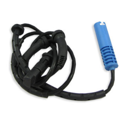

I would like less ecus.I will have to sort out the speed sensors.Are these in the front hubs and rear to.What do they look like as i dont want to sell the parts that i will need thanks hope you can help
Front and rear for DSC they look like this post-462-0-55729300-1360603568_thumb.png

Hi so it looks like i will have to keep the abs.I have been told this before.And i have been told the gears work on road speed.So to sum it all up do you think its possible.So are we saying the engine will start with no abs plugged in but it will not drive,So i will need it,
Does the BMW box use a torque converter, like I would presume your yank tank will, if so you could see about mating the Ford torque converter to the BMW flywheel and making an adaptor plate to put the Ford box on the BMW engine that way you won't have to worry about the abs, there are ways of making the engine run without the abs but you need to be quite a good auto sparky to do it
Hi the ford gearbox is manual and i am sure it wouldnt fit.I could have broght a manual bmw but i really wanted a auto. Could you tell me is the ABS on all the four wheels.Are the speed sensors on all the four wheels to or just the rear. thanks
