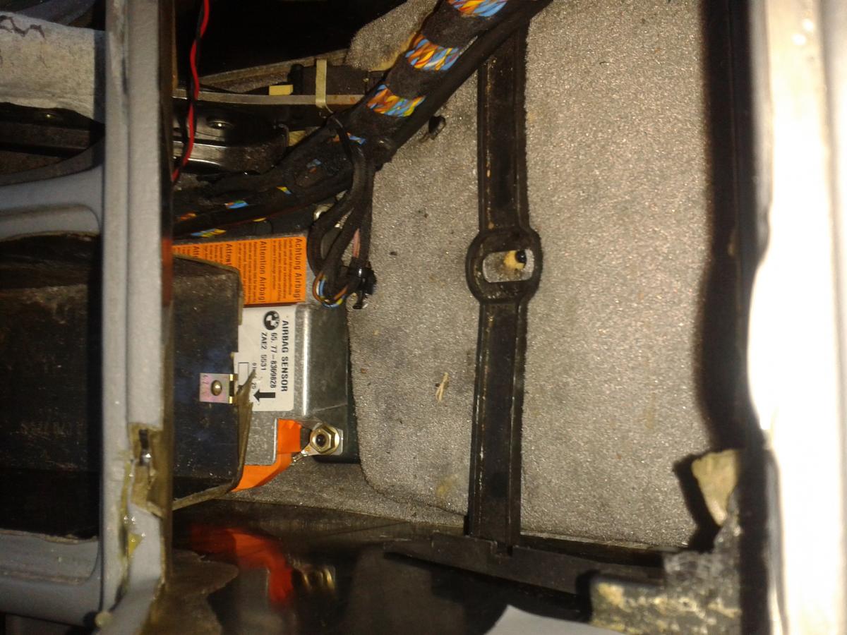

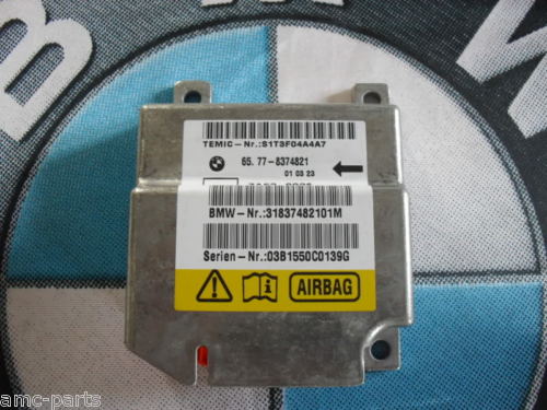

hi, still not found the ecu. if anyone else can help, it would be welcome. don't fancy taking all the interior out unless i have to.i've attached an image of the ecu. has a single orange connecter which you can just see in the image. thanks
hi, yipee i found it. close to where you suggested. under the centre armrest. removed the centre tray and there it was. thanks for your help. ps. if you want to put this up on the helpful tips or 8 series page page you can.
