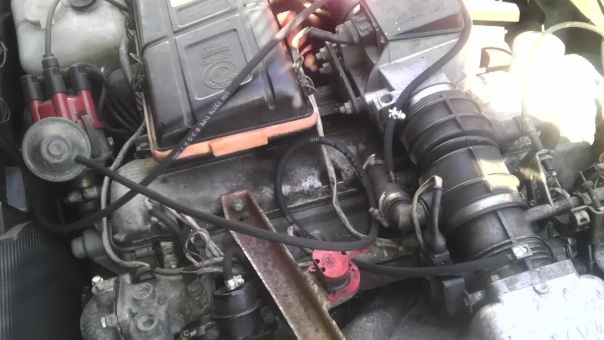

I've took a few pics and I'll try explain but Im a bit stuck now.

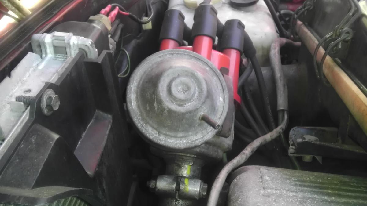

Right, we have this sitting on top of the dizzy with a location above and one below for a pipe

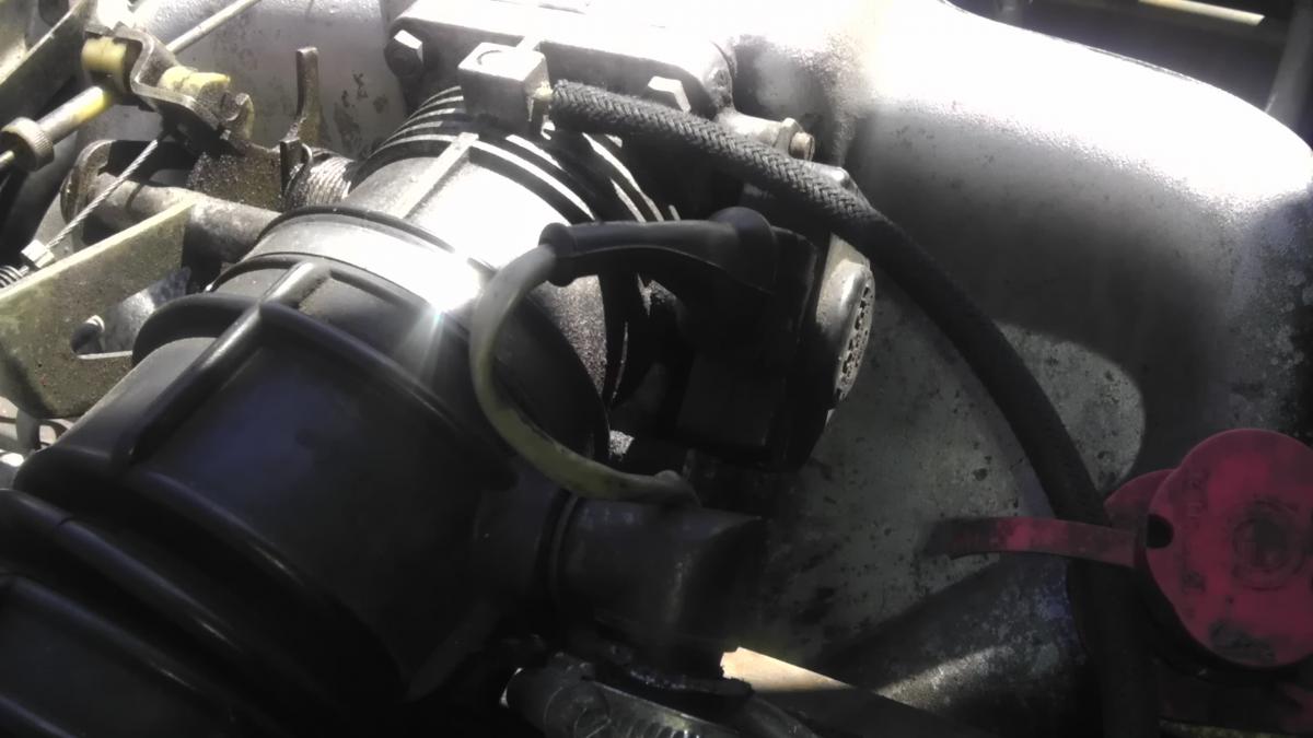

We have a location on the top and bottom of the throttle body

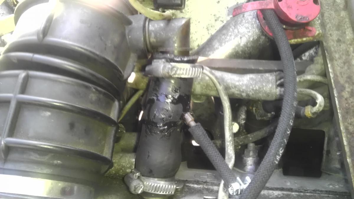

We have this one here that bridges the rocker cover to the airbox side of the throttle body
And one at the underside of the inlet manifold.
Bit difficult to see here but this is how im piped up at the moment.
1.From underside of intake mani to underside of throttle body
2.From top location on dizzy to top of throttle body
3.From bottom location on dizzy to pipe that bridges rocker to throttle body
Cheers in advance guys

At higher revs, the distributor needs to change its timing. This is usually done with a spring system but that valve on the top looks to be the way the M30 does this. The pressure from the engine most likely acts upon that valve to alter the timing. Without it, at higher revs the car will lack power. I imagine the vacuum line would come from the inlet manifold.
RealOEM isn't helping a lot when it comes to the distributor.
This is what I make of it...
The nipple ontop of the throttle body seems to go UNDER the dizzy.
The nipple ontop of the dizzy seems to go over the rocker-cover and down to the bottom of the inlet manifold.
I believe, the reason for the lumpy idle and terrible throttle response is to do with the distributor. Like my M20, You can spin it with your hand to either Retard/Advance the timing. I used to retard mine to give it a lumpy idle but suffered badly with performance. You can turn it to the point where the car loses enough revs that she stalls so this really makes sense in my head.
My money is on the dizzy slipping.
Hope this helps
